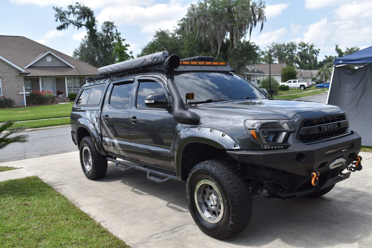

    Hey guys! I went through about 100 pages of this thread. I didn't find too much info on my configuration. Any input will be appreciated!
    2013 4x4 4.0
    full ALUMINUM front bumper (Coated in Line-x)
    Smittybilt Synthetic winch
    SLEE beefy sliders with top plates
    Camper Shell
    KB Voodoo shelf (probably 60lbs loaded)
    Rear steel Pelfrey bumper (coated in Line-X)
    Prinsu camper shell rack
    I'm guessing the 9000 series and the HD Leafs are right for me. But the front coil springs...…..886?
    I don't want to be too firm up front but I don't want to get a lower spring (888) and have sag and regrets.
    Also....anybody buy from Rock River? They make a comprehensive kit that includes in-house made UCA's.
    Truck is my daily driver with limited weekend-warrior time due to a new daughter :)
    Thanks!!

    If it were me I'd go 886x coils 9000s shocks spc ucas and hd leafs and the ome rear shocks

    Agreed on the 886's. Buy once cry once. Never heard of Rocky Road but their pricing is comparable to the well-known vendors here on TW. Customer service is a big factor for me in deciding who to give my money to.

    I appreciate the info. I will get the HD rear leafs for sure. I think the 886 is the way to go. I just didn't know if I'd be on a rough ride due to my more minimal weight add-ons up front compared to a full steel bumper and full steel winch.
    Any reason for SPC's versus the Rocky Road kit? Seems SPC is more adjustable but with such a small lift I don't think you need much.
    The Rock Road kit comes all-in, including UCA's for $1600 (fully assembled). I agree about customer service. They've been very responsive via email and phone.
    Anything else I should add to the Deluxe Kit? It seems to be a very well thought out system and includes the trim packers, diff drop kit and, bushings, U-Bolts, UCA's, springs, shocks, leafs, and a fit kit to level out the truck 5/8'' up front.
