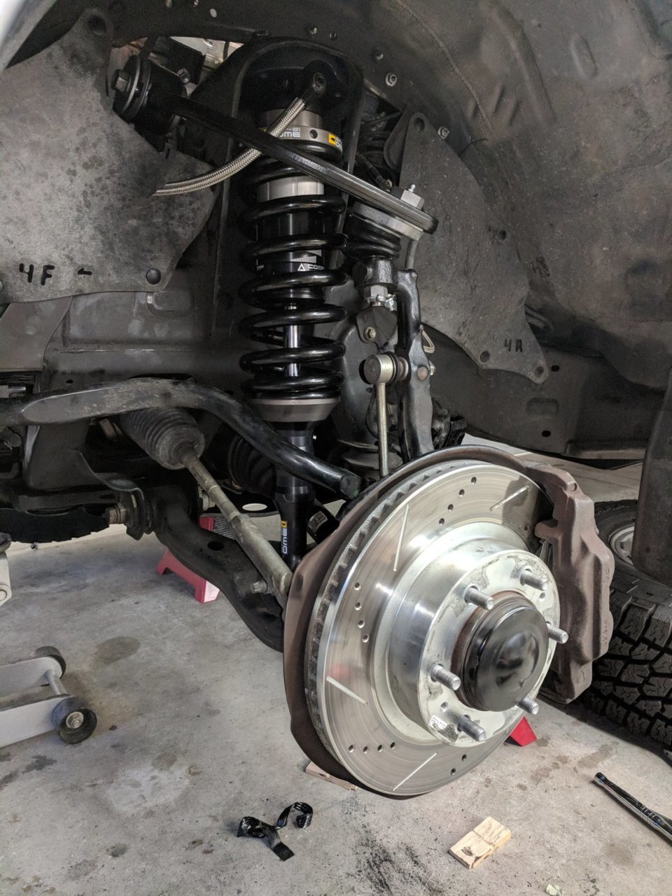

    Headstrong has everything you need. Get the SPCs, makes alignment and irregular tire wear a non issue with ride height changes.

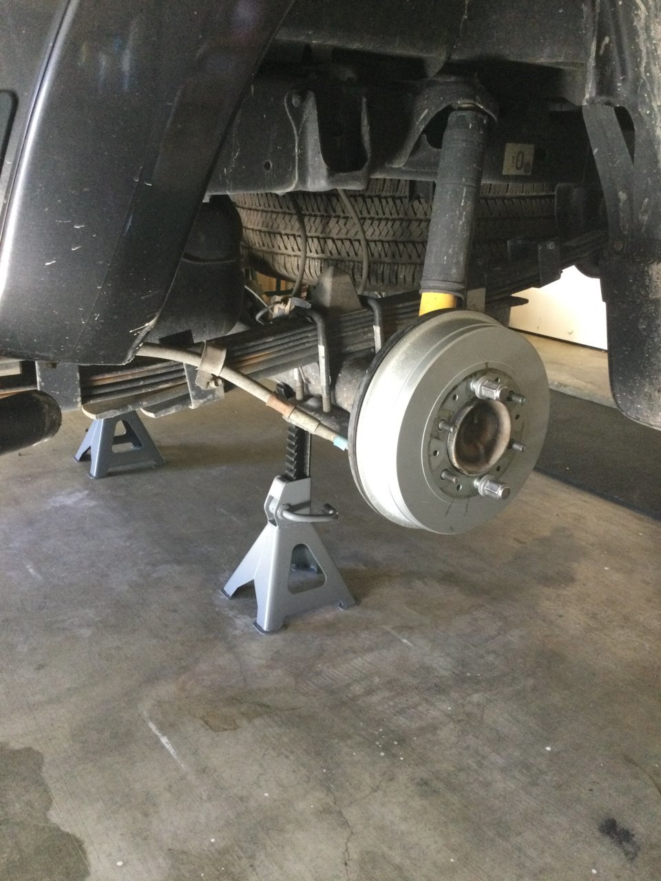

    Rear leaf question... is this normal?
    I have 885s with Nitrocharger sport shocks up front. MD springs EL095R. I installed the lift about a year and half ago. I have my initial measurements somewhere so I have a good reference for any settling. I just changed out my brakes and noticed the “W” shape in my leafs. Tried my best to get a clear picture of it. I know the spring hangers were super tight but is just the springs being over loaded or could the bushings not be moving. I carry around probably 200lbs of tools all the time and added a camper shell. I know the medium duty are supposed to maintain on a constant load of 330 lbs but I don’t know if that would push these out of shape like this. Thanks in advance.
