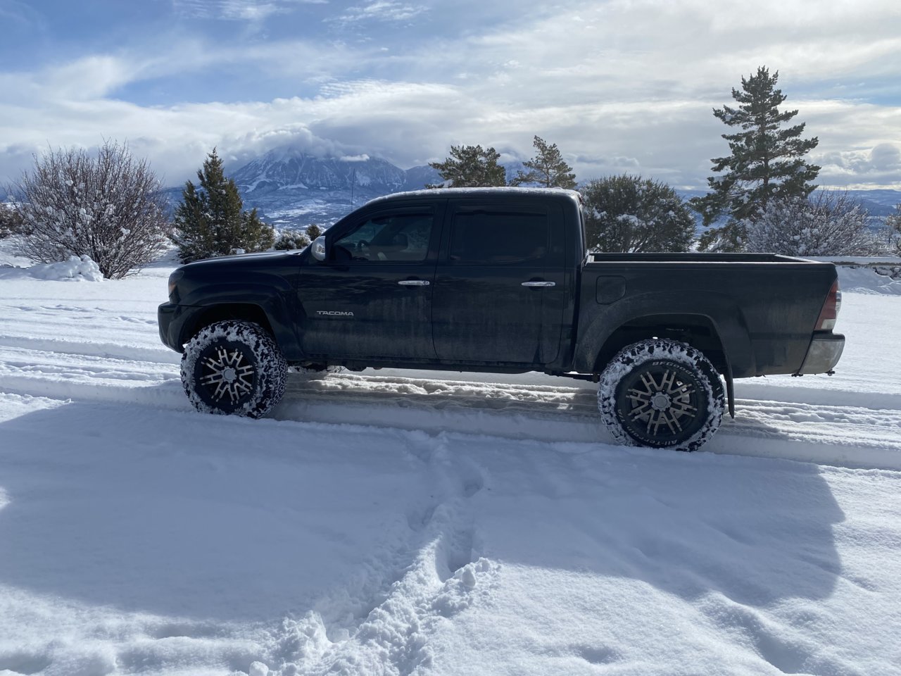

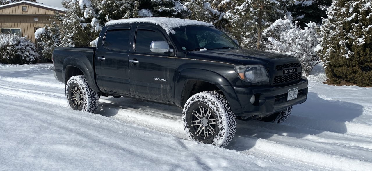

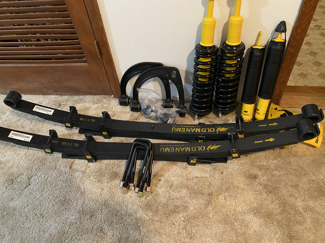

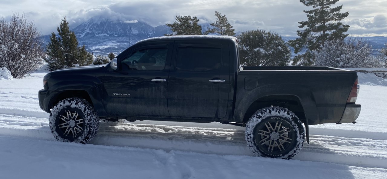

  20. Dec 29, 2020 at 1:08 PM
    Railroad_Earth
    Railroad_Earth Well-Known Member
    Dec 7, 2017
    #237864
    108
    Black 2010 DCSB
    Welp, finally had a couple extra minutes to snap some pictures. Install was way easier than I expected. Took me and a friend with a lift, all the right tools and experience about 5.5 hours. 887s with nitro soft ride struts and nitro shocks, SPC UCA’s and Dakar medium duty leaf pack. I already have the add-a-leaf to make the Dakar’s HD when I get topper, rack, RTT etc. love the ride but that was expected as this is my third Toyota with OME suspension. 03D1FC67-8801-4527-97E4-2D3881FBFCE5.jpg7F7CA738-3AB7-4A96-869F-BE2E06053342.jpg 735599BD-B9C4-4366-A10E-9635C0CC7F85.jpg
