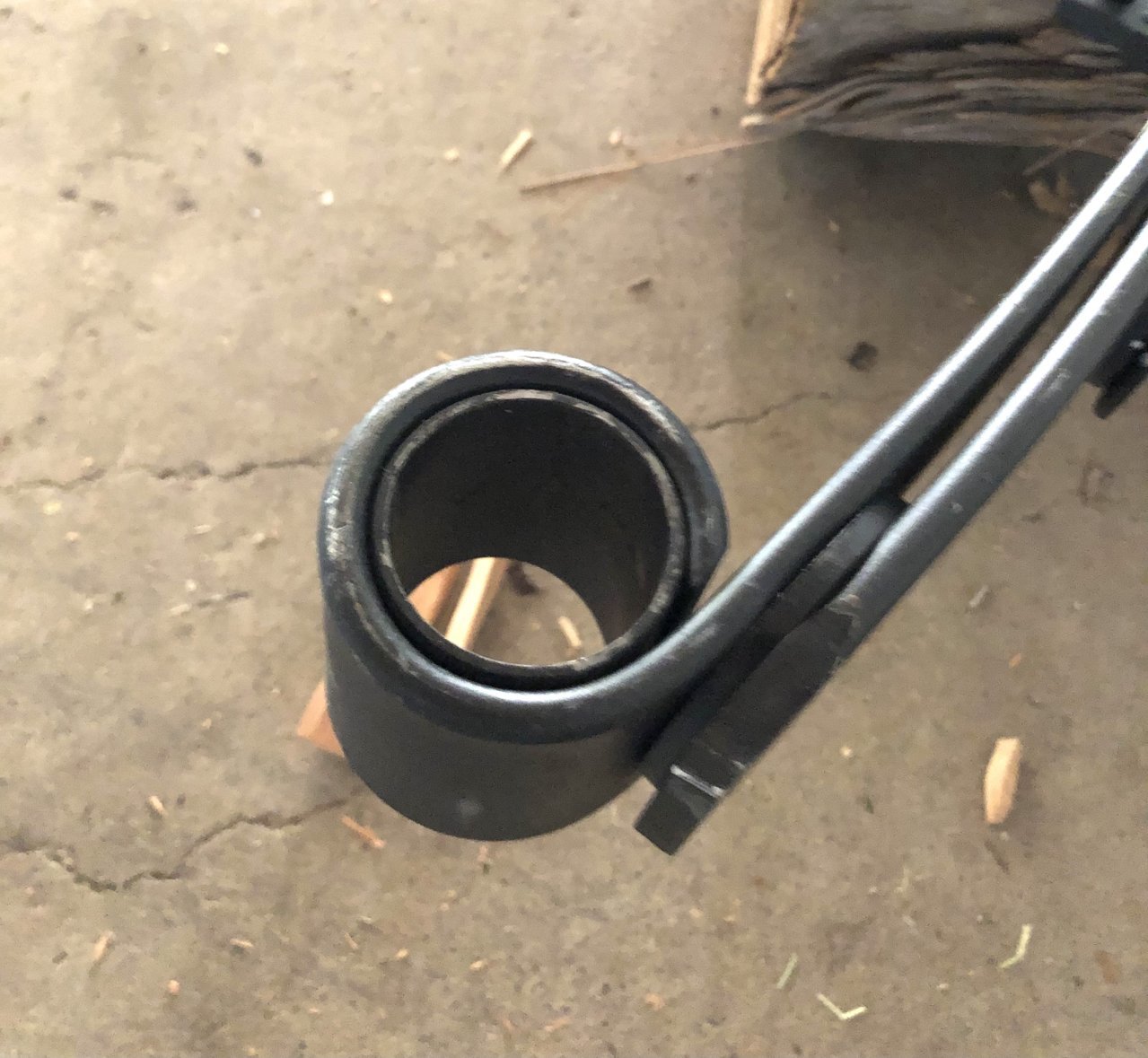

    Hey guys,
    any advice on how i can remove this sleeve so i can install the rubber OME bushings?
    geekhouse23 likes this.
  14. Jan 8, 2021 at 3:25 PM
    geekhouse23
    geekhouse23 The "Liftman" - @DrFunker
    Jul 14, 2013
    #108251
    15,695
    2GMGMDCSB4WDTRDFTMFW!! TL;DR
    mostly stock, grocery gettin' Prius
    Sawzall it in half then use a pry bar and a BFH to hammer it out
    la0d0g and boston23[QUOTED] like this.
  15. Jan 8, 2021 at 4:09 PM
    boston23
    boston23 Well-Known Member
    Sep 4, 2019
    #304290
    3,740
    Adam
    Eastie
    2019 SR5 DCSB 4x4
    Hacksaw it is then! lol
  16. Jan 8, 2021 at 4:31 PM
    la0d0g
    Jan 25, 2011
    #49903
    19,880
    running for the hills
    For crawling not hauling
    Impact hammer should work as well.
