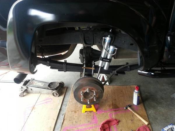

    ???????....Tomorrow is install day for Dakars and extras. Just looking for input if I've forgotten anything or suggestions on install tricks, etc. I've search here and read a ton (Thanks for all the info!). All existing hardware has been being treated with PB Blaster for a few days.
    Here's the list of parts I have:
    Dakars w/aal
    All-Pro u-bolt flip kit w/Timbren bumps
    Wheelers bushing kit
    Bilstein shocks
    ToyTec extended brake lines (already installed)
    Any info is greatly appreciated!

    One side at a time.
    Install the front of the Dakars first.
    4 jack stands. Two for truck & two for the axle. Use bottle jack under front of diff to keep it from rotating.
    An extra set of hands to slide the bolts in.

    Thanks for all the previous pre install info! Finished installing my Dakars and other rear suspension goodies. Looks F'n fantastic and rides great!

    why are your u bolts upside down?
  18. Apr 28, 2013 at 6:40 AM
    #1238
    ndcmack
    ndcmack Well-Known Member
    Mar 14, 2013
    #99735
    1,566
    NICK
    Washington
    BSP 4x4 TRD DCSB
    Not enough
    All-Pro U bolt flip kit. Check them out it's a great setup
