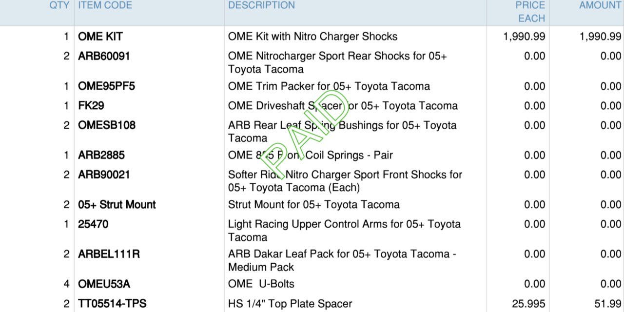

    Hello everyone, I just ordered my lift kit and was looking for some input. Is there anything you guys would recommend me doing differently? and Is there anything you would recommend that I know before I install it? also thoughts on the 1/4 inch spacer? and last question how much lift do you think I will achieve front and back on my 2006 tacoma double short bed cab 4x4 with a topper and no other added weight other than about 150lbs of tools in the bed. Screen Shot 2021-01-29 at 8.13.51 PM.jpg

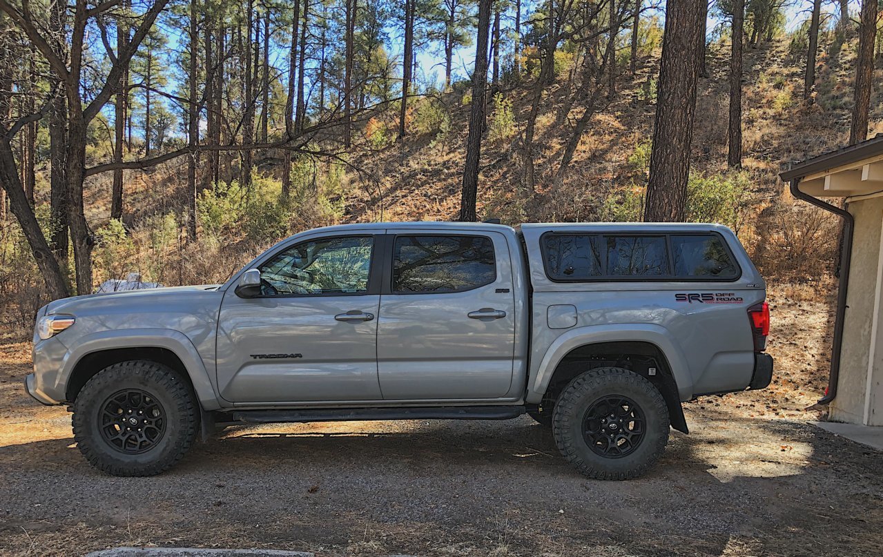

    i have an ARE shell and i think its sitting level now that they settled. Before they settled the truck had some nice rake. My rear was squatting on the stock suspension so at least its level now. The 600lb constant load of the HD’s sounded too stiff though. Here is a pic the from the day i installed them...cuz why not post truck pics, right?

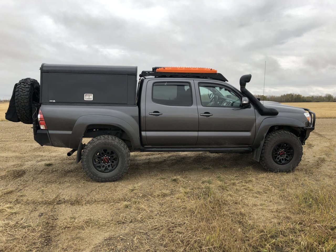

    In the summer I was loaded down really good and was sitting about 3/4” off my superbumps and could tell I was hitting them over some dips on the highway. May be time to upgrade if the new pack will be more heavy duty. Hello Deaver Expo stage 3.

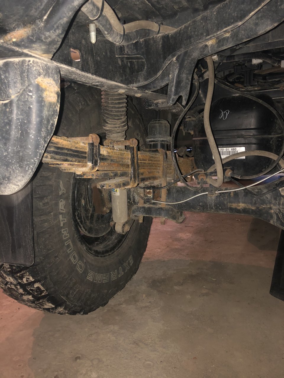

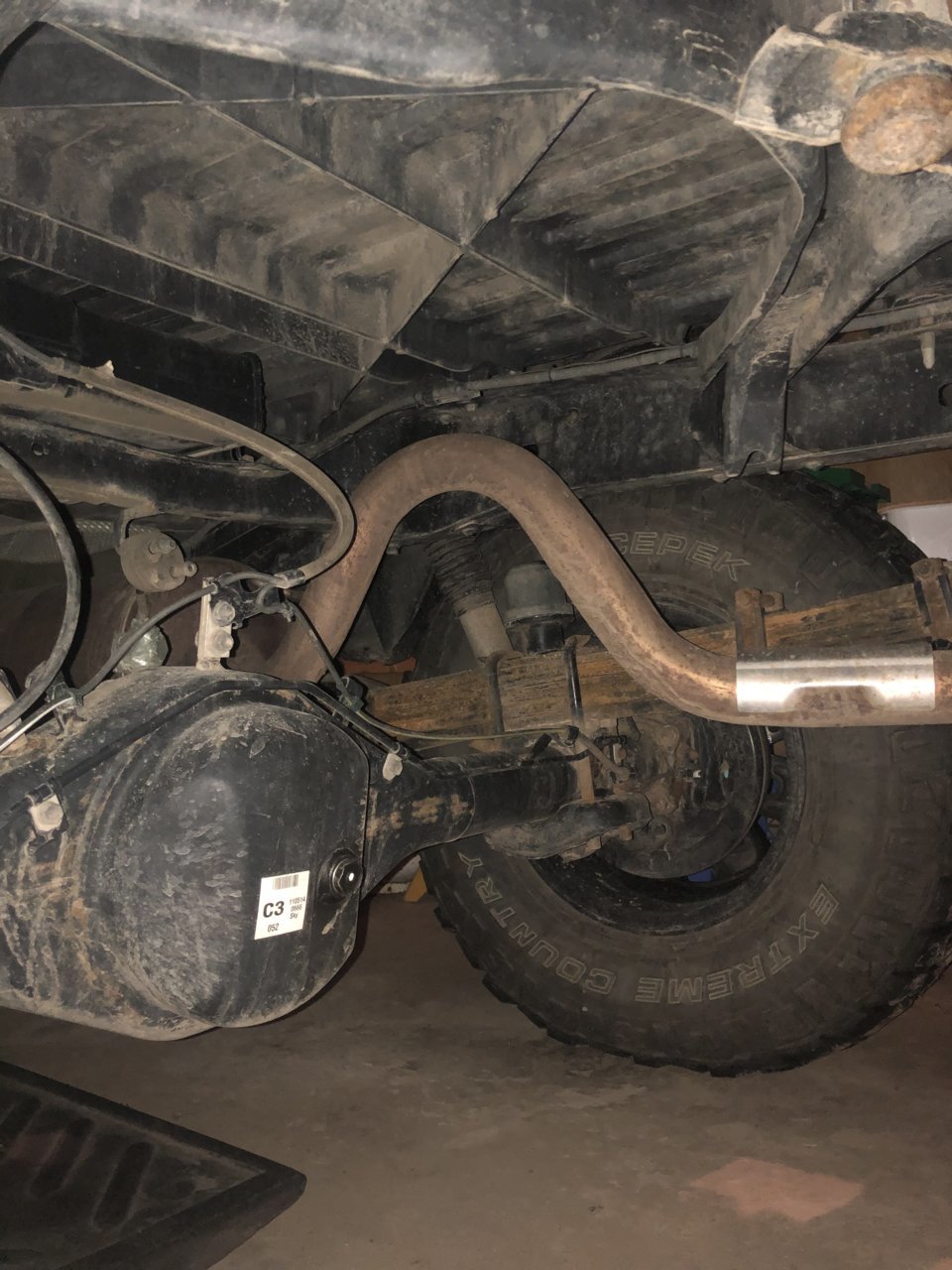

    Not impressed with these Dakars CS047R w/D29XL aal both for load carrying and finish. You can see they’re flat or negative already. I have not abused these or even carried a lot of weight very often. This is with approximately half of the weight that should be in the bed. Last pic is when they were new.

    IMG_1381.jpgThis is unloaded (ie. nothing in the bed), but I have a steel CBI bumper with dual swing outs w/2 20L gas cans, Highlift and 85lb wheel/tire and steel sliders. I have not weighed my truck but my guess is that I have an extra 550-650lbs (excluding the above) when loaded. I'm going to weigh the truck this summer to confirm all of this.
