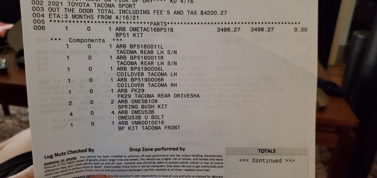

    Just got back from the shop getting an estimate, does this sound like a good kit for a fair price?
    • Old Man Emu BP51 -- ~$3,500
    • Old Man Emu Control Arms -- $548
    • Sway Bar Relocation -- ~$40
    • Installation of BP51 + Control Arms -- $1,000
    The $1,000 installation makes me wish I had car guy friends and/or a garage... :(

    Final damage on the OME lift (without install, still hoping to find a shade tree):
    ARB is saying 3-6 month backorder for the kit :annoyed:
