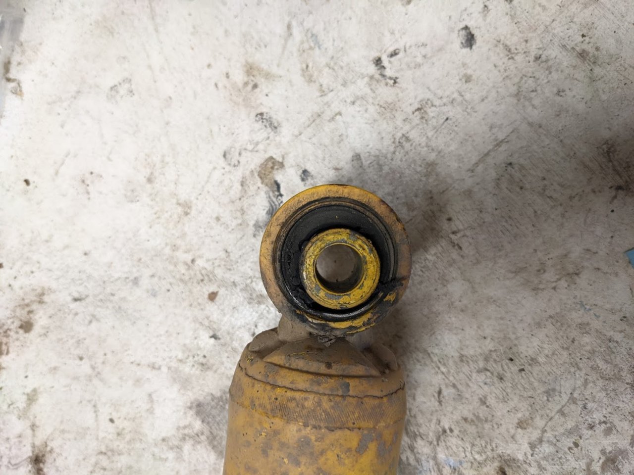

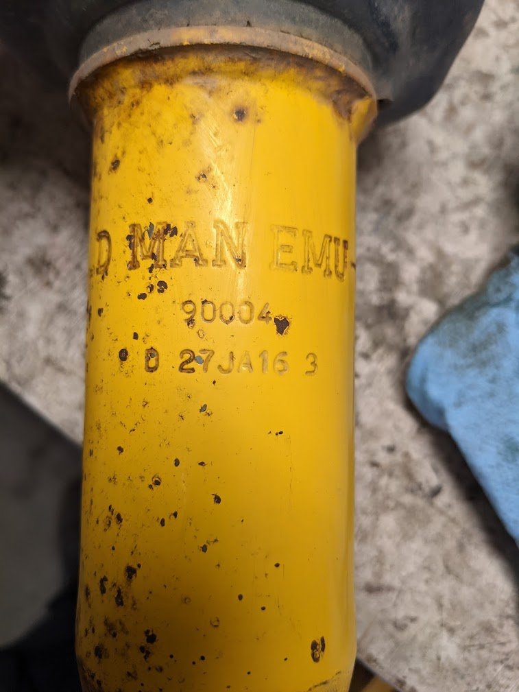

    Got some Nitrochargers 90004 and the lower bushings are going out. Anyone know the part number for a replacement?
    ovP_gMv-A-E1MLLnV6i9d-klxzR1EUfm9nO65KNT_cb8aa39d80360e8bd5c7679f0c57974d471ae2f4.jpg
    rXowZcExphkUt8KkwedenWFz3CVmIM6fYEN4AfHX_cebf289cd15dce6117b235c929244617933be0fb.jpg
    EDIT: Heard back from ARB. It's ARB 110-110-122. SM673 is for the upper bushing. Now just need to fine them cheaper than $35

    That's the price for a set of bushings, isn't it? Can't be for one bushing, unless it's made from genuine Australian Abo.
    The bushings on my Land Cruiser OME's turned to dust a couple weeks ago (after 20 years) and I need to replace bushings in all four shocks.

    After 20 years....why wouldn’t you just replace the shocks? They come with new bushings pre-installed ;)
