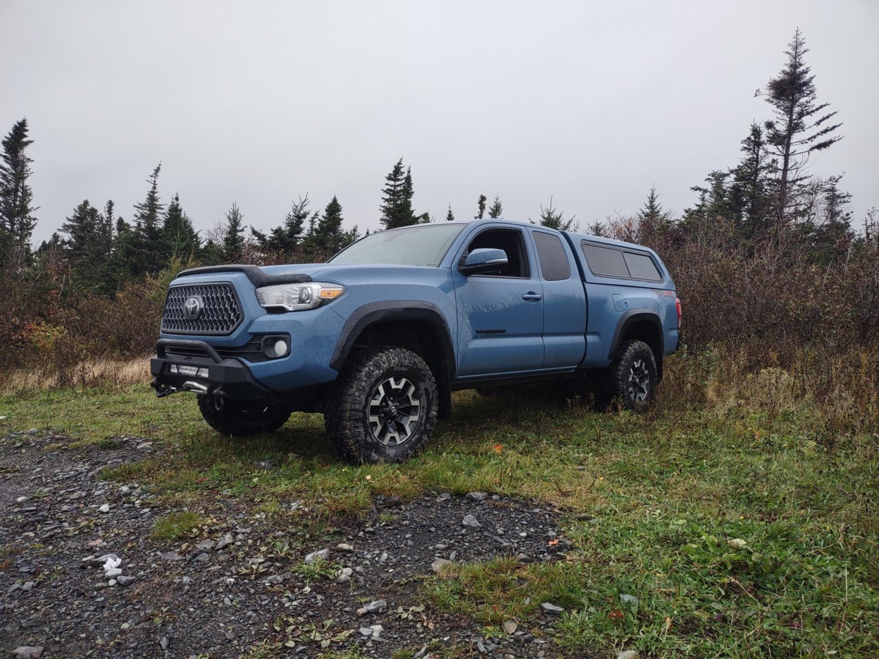

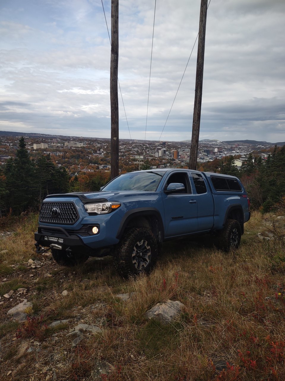

    IMG_20211023_151723929.jpgFinally got parts stuck to the new rig! Full ome med kit. Got about 3inchs all around, with center bumper and x20 winch. I was on the fence on which way to go. Im glad I went ome! Ride is amazing!
    clem408 and acdubstaco like this.

    What size tires you running? I have pretty much same setup but in silver and looking at OME med kit. Any other pics?
  14. Oct 31, 2021 at 12:17 PM
    Snowmonkey800
    Snowmonkey800 Member
    Jun 3, 2021
    #367533
    14
    Allan
    19 taco access cab TRD off road.
    Only this other one so far IMG_20211023_104235327.jpg I'm running a 265/75 dura tracks for now. Looking into some 255 when they become available again.
    Good kit. Only "problem" I'm having is full droop it hits kinda hard. Upper control arms might be the issue haven't really checked yet. Otherwise I'm pumped on it. Rear bumper comes next week. Hopefully the med kit holds up. If not I'll add a leaf.
