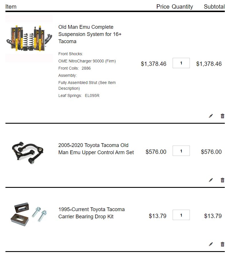

    Think I'm going to pull the trigger. Wheeler's has a Black Friday sale right now and their OME kit comes with NitroCharger front/rear shocks (90000 firm), springs (886), Dakar rear leaf springs (EL095R), Wheeler's polyurethane bushings, 95PF5 front trim packer, FK29 driveline bearing drop kit, and Wheeler's u-bolts. Added the carrier bearing drop kit and some UCAs; not sure if I need the UCAs but my gut says get them anyway. Also getting the ECGS bushing with tools. Anything I'm missing?

    I just installed the same (886/90000 front) from Wheelers other than I went with heavier (112) rear leafs on my 2021 TRD OR SB.
    - The FK29 is the carrier bearing drop
    - the EL095 are now the newer 111 and the heavier EL096 are the newer 112
    Front lifted 2 1/4 inches without a bumper and winch on it yet
    Rear came up 3" until I loaded 700-800lbs of gear in the back and it settled to 1 1/2"
    No need for UCA's or ECGS. CV angles are fine and I don't have a bumper and winch on yet.

    So have the EL095 and EL096 been replaced with the 111 and 112? I see that they still have 95 and 96 only listed on the website. So you ordered from there but got the newer style instead?
