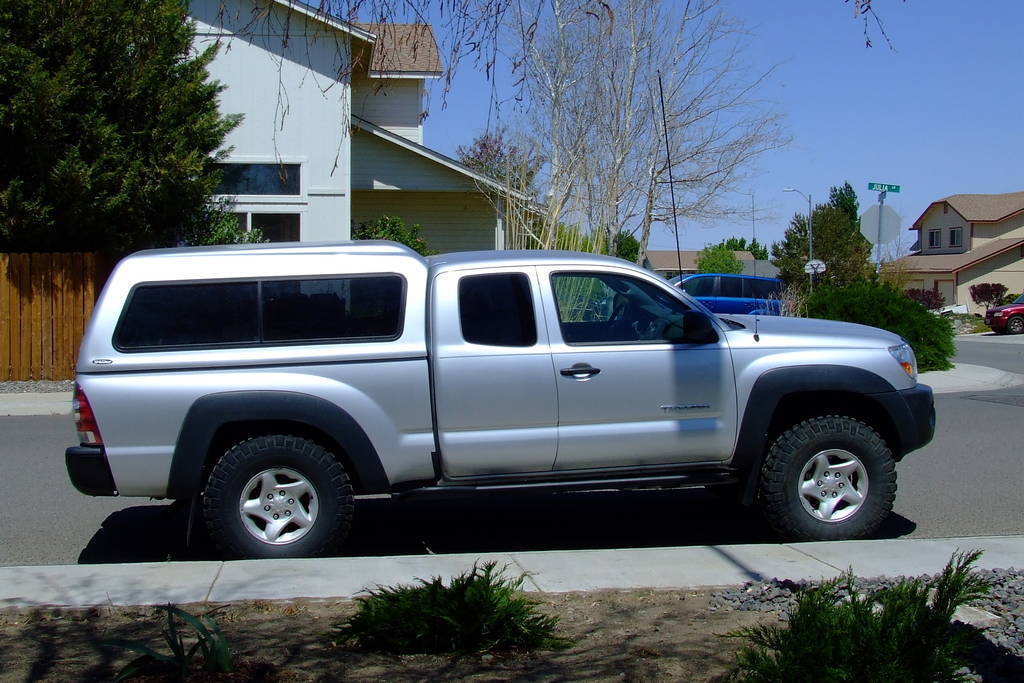

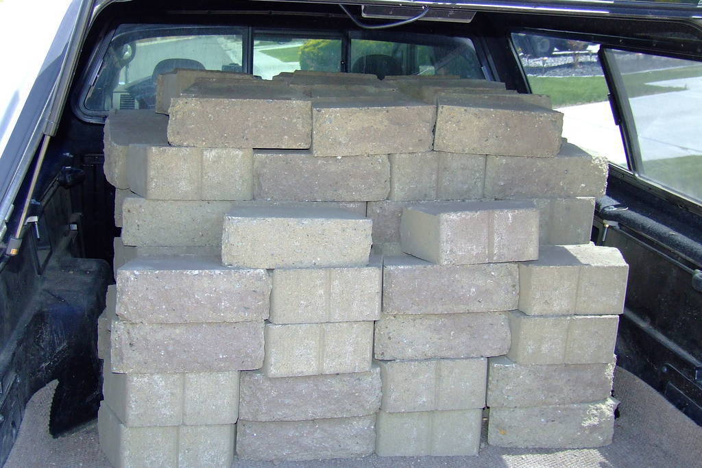

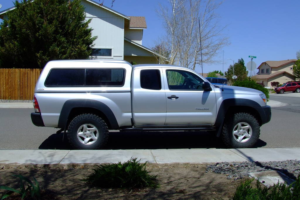

    For those of you wondering what the Dakars can handle it's a lot.
    This is 126 25lb retaining wall blocks 3,150lbs (1 1/2" from bump stops). Load is not centered over axle or all the way forward in bed. The truck would have gone a lot less Bro if I had loaded it all the way forward.

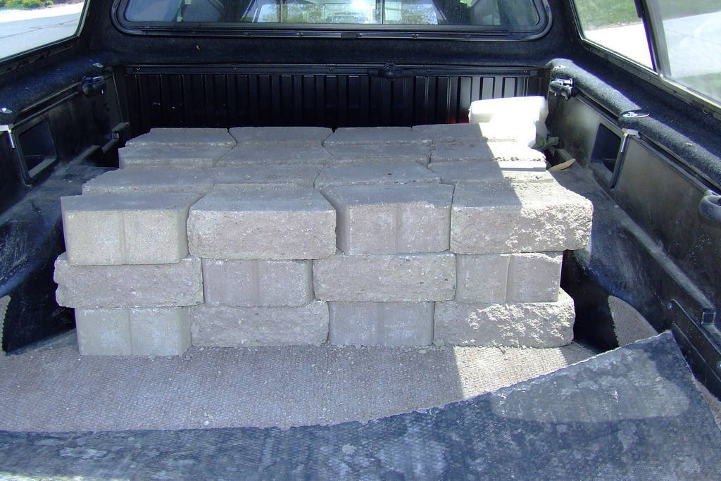

    This is 48 25lb retaining wall blocks 1,200lbs centered over axle (3 1/2" from bump stops). Rides is a lot better with the 1,200lbs than it was with 3,150lbs. The front was a little light with the 3,150lbs.

    I am confused by your question, are you talking about the UCA hitting the coils or the tire rubbing the UCA?

    Are you not just resting on the bumps?
    They are not handling the load if on the bumps. If they are off the bumps that pretty impressive.

    With 3150lbs 1 1/2" off bumps.
    With 1200lbs 3 1/2" off bumps.

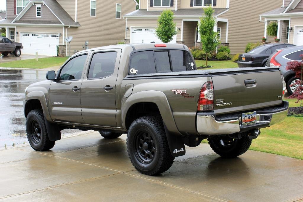

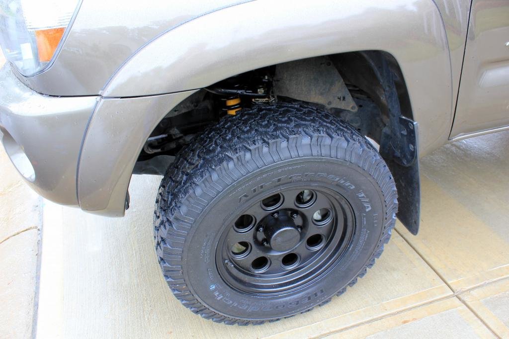

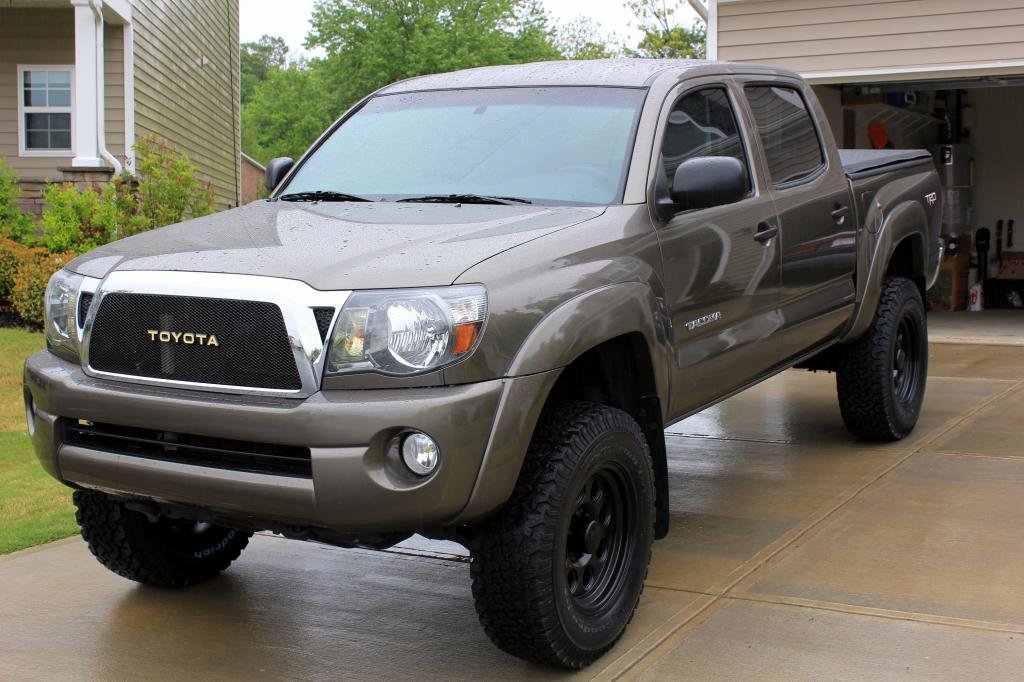

    Full 3" OME Lift, Sport Shocks with top plate spacers and 885 coils, Light Racing UCA, Sport shocks and Dakar leaf springs, Avid Light bar, Avid Step rails, Grillcraft grille with 70's Land Cruiser emblem, custom vinyl stickers, window tint, selective debadging, fog light anytime mod
    Lift installed yesterday. Full 3" with Dakars. Alignment tomorrow hopefully. More functional (Avid Light bar/Step Rails) and cosmetic (debadging/blacking chrome etc) to come.
    Thanks for all the advice/hints! Took my friend and I a little over 11 hours.
