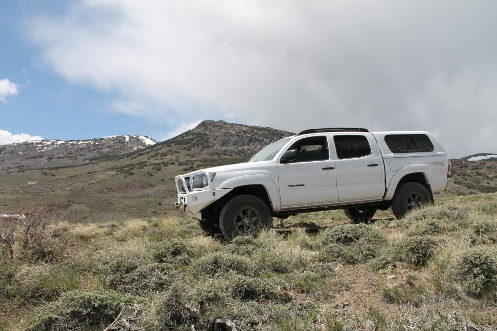

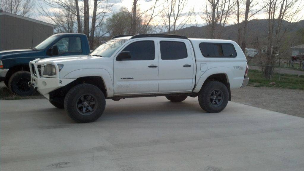

    I'll add some stuff on my truck. My set up is 885x's with plate bumper and winch. Before I got my lift I read a ton about the addition of a bumper and winch, and what coils to go with. Everyone says 886, which to gain about 3" with bumper and winch is what you need. My worry about going that route, was it was going to be a few months of lift with no bumper, and I wasnt pumped about it riding super rough. In my case, I wasnt worried about getting the full 3" to clear tires because I plan on only running 265s. I was worried about spring rate though, and it being too squishy, both on the street and offroad with the addition of the weight. After a few weeks of running this setup, and some mild offroading, I can say I notice it is squishy. Its not bad though, definitely not "I need to change immediately" I can say though, now that I have LR ucas with proper caster, there is no way you could clear 285s, without serious cutting anyways. Without measuring(which I will try to remember to do tonight) I am going to say I lost about 3/4"-1" with the bumper and winch. My rear set up is stock TSB pack with the deaver 1.5" AAL. With my shell, before the plate bumper, the truck sat dead level, which I dont like. Its a truck, and when it's loaded with gear or dogs, it shouldn't sit bro'd out. Now with the weight it sits with about a 1" rake. Perfect! I sometimes have crazy ideas of putting 285s under it, in that case, I'll go the 886/dakar route. Hopefully this helps someone in some decisions. Now for pics!
    This with dogs and my recovery gear. 200ish pounds. Parked slightly nose high.
    Hard to tell because its parked on a slant, but this is the same load.
