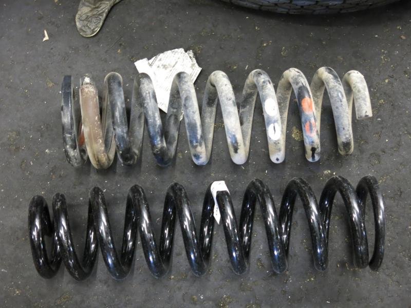

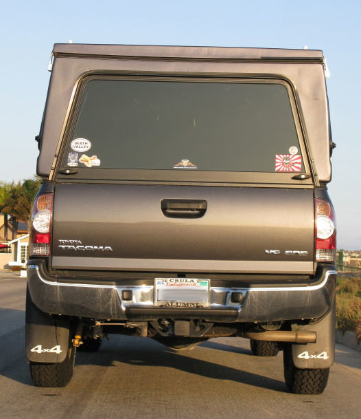

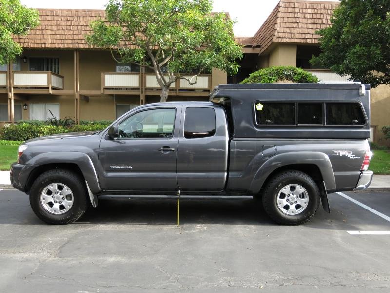

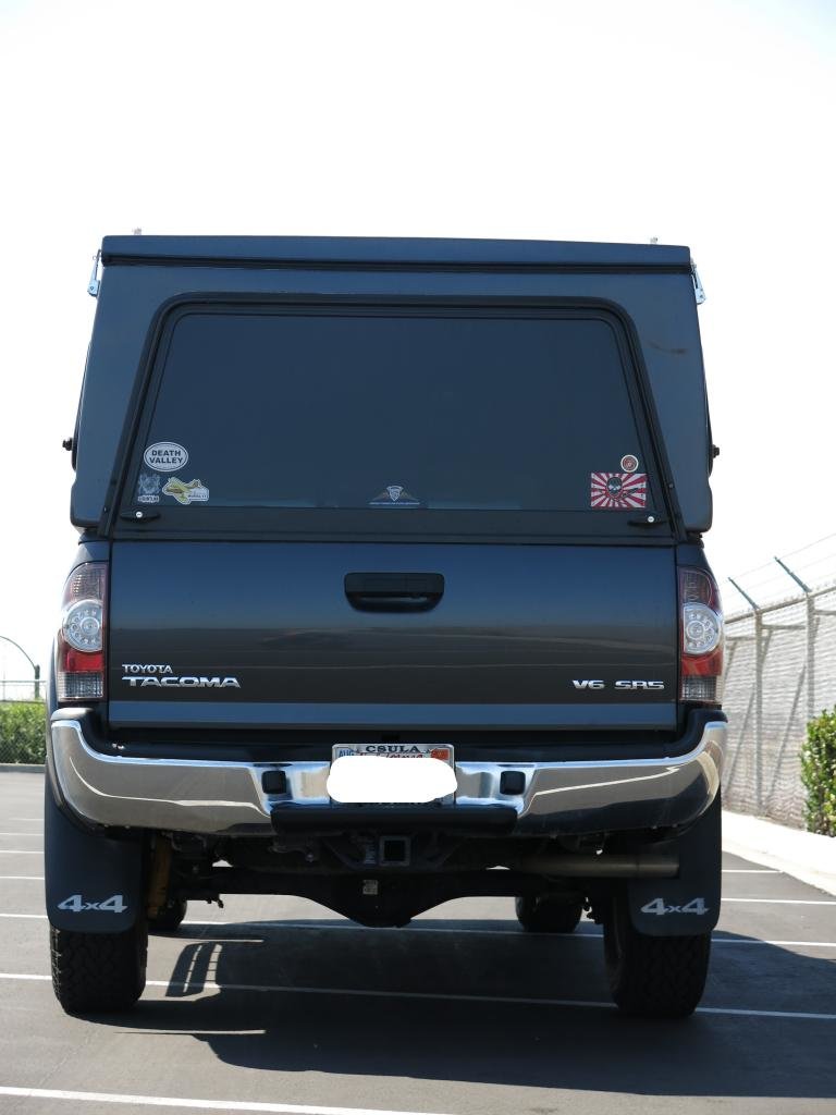

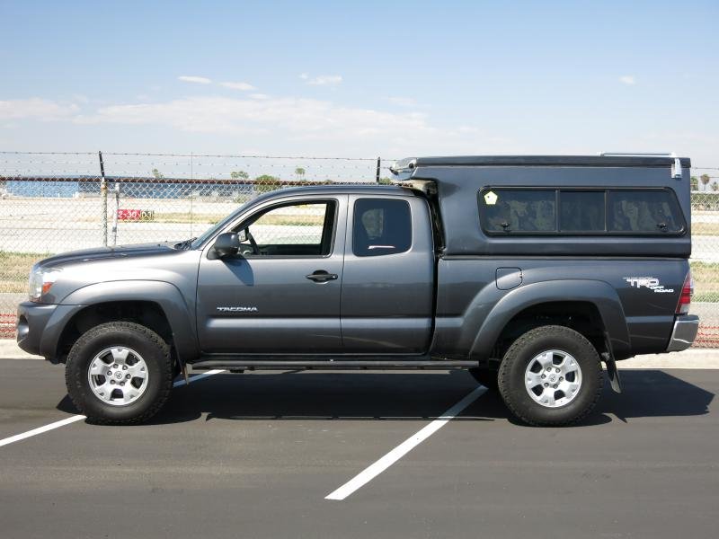

    Very happy to finally have some new suspension. I ordered through TRDParts4U. The following are the results:
    What did you put up front & what did you get?
    885X and 90000 NitroCharger Sport front struts
    Driver side increased by 2" and passenger by 2.5"
    What did you put in back & what did you get?
    Dakars and 60091 Nitrocharger Sport rear shocks
    Rear height increased by 3.5"
    This is significant but relates to how much the TSB Leafs and Bilsteins had given way to the loads I have carried during off-road exploration. They were shot! The drivers side rear shock was blown and the plastic shroud was melted.
    Are you running trail armor & how much lift did you loose or what did you do to regain/maintain lift?
    NO
    Tire & wheel specs & rub or what you did to eliminate rub.
    Stock Alloys but want the TRD pseudo beadlocks. No rubbing.
    Tires are General Grabber AT/2s in 235/85/16.
    Are you still running a sway bar?
    Yes
    I also measured from the center of the outer tube of my sliders.
    Drivers side got 2.25 and passenger gained 3. I still have the taco lean but I also have the drivers side of the bed loaded more than the passenger side.
    Old vs New
    Rear shots
    79dbbb69-1dec-4511-8f20-9424dacf0c03_zps_30e660f9cbb5de333b62bae32c5d8d465d5e0b9d.jpg
