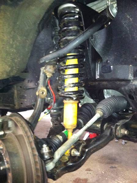

    That Apex bumper is a big ol bitch, and I had to use the trans attachment on my floor jack to get the skid on.
    *On second thought, that's about right. They are both supposed to give the same amount of lift.

    Just measured mine stock with about 1/2 tank of gas. DS 20", PS 21"
    Hopefully 885s with the 13mm spacers will get me 3" exactly.

    What's supposed to give the same amount of lift ?

    885's with 1/4" spacers can do that

    That's pretty extreme:eek:
    Try the 885s by themselves first.
    By design the 885 and 886 are supposed to provide the same amount of lift in theory, its the spring compression rates that are supposed to be different. I guess actual results do vary.
    Naw. Order them from Wheelers preassembled and you can do it yourself. And if you need the 1/4" spacer that's cool because the studs will accommodate them. You can put them in later if needed.

    886's are also longer than 885's

    Thats full extension up on jack stands.

    I assume thats part of the "engineering" to help deal with the added weight.

    with tires on, at rest

    Much less angle on the CVs in that scenario. When I get a chance I'll crawl back under there and measure the angle with the truck on the ground.
