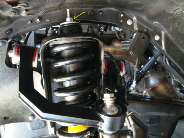

    those are DSM uca(down south motorsport) but there are people with LR uca and tc uca with the same issue, so it's probably not the uca's

    overextended shock makes a lot more sense right now.
    does anybody know what the torque specs are for this bolt? what if i loose this bolt a bit would it give me more travel?

    I'd be willing to bet it's someting that wasn't tightened down correctly (assuming everything is installed correctly to begin with)
    Do NOT loosen that bolt. That bolt keeps the coil on the shock. It needs to be tight and kept that way. Also, a shock's travel range can not be altered (for all intents and purposes).

    It wont give your more travel. I don't know that there is a torque spec on it, but i think that if you over tighten it would be bad for the bushing. For example on the rear shocks, If i am remembering correctly OME recommends only 3 full turns after the bushing starts to compress.

    IDK i took the coil and shock to a shop to get them swapped since i didnt have a spring compressor.

    There was a thread just a few days ago by someone who installed 5100's and had a "clunk". Turns out the coil when compressed was hitting the top mount surround. The coil was not installed correctly and it needed to be spun to sit properly.

    I can think of a way to test the over extended shock theory but it might not be the safest thing. Put the front of your truck on jack stands then put a floor jack under the tire, jack it up an inch then drop the jack and see if you can replicate the noise. I don't recommend doing that, i would be worried about the stress on the suspension, and the truck being stable. but if you are determined to find the cause of the noise you might be able to figure it out that way

    It looks fine, the bushing doesn't look to compressed

    That could definitely be it. Its hard to tell anything from samsungs picture but it looks fine to me
