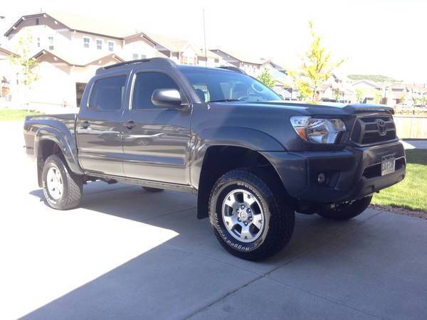

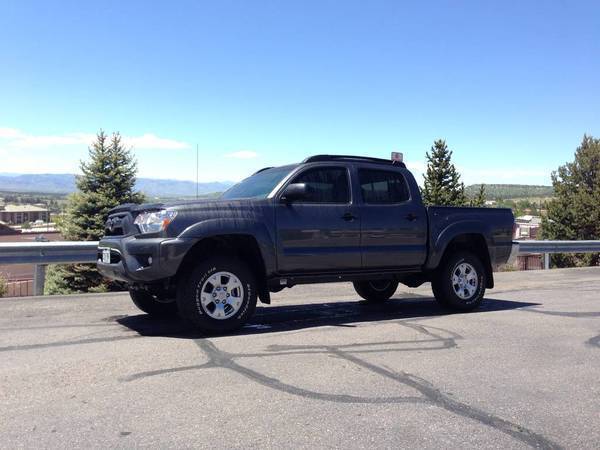

    WeatherTech Digital Liners, ImMrYo rear view mirror bracket, color matched grille, Tacoma door sill protectors, OEM hood protector, clear bra, tint, OEM roof rack, trimmed front mud flaps to match rear clearance, debadged, color matched grille, Plasti Dipped front Toyota emblem, OME 884X coils with trim packer on driver's side, OME Nitro Sport 9000 shocks, Deaver/ToyTec AAL with OME N182 shocks, 265/75/16 Duratracs, ProComp 7032 16" wheels
    Finally got around to installing the suspension! Like a doofus, I forgot to get before/after pictures as well as measurements. I'm really happy with the way the truck looks and performs. Smooth, but firm ride (very close to stock, but a tighter feeling). I was able to get the lift done, as well as swapping my old stuff onto my wife's 4Runner with a few friends in just a little over 3 hours. The pictures are pretty bad, so I'll try and snap some better ones at a later point in time.

    Sorry if you posted it further back but what lift did you install? and the rear? asking cause it looks good!

    '13 TRD Off Road 4x4 DCSB MGM JBL/Entune/Nav
    No worries and thanks!
    -OME 884X coils with trim packer on driver's side
    -OME Nitro Sport 9000 shocks
    -Deaver/ToyTec AAL (I do NOT have the TSB leaf pack though) with OME N182 shocks
    Netted around 2" up front and 1.5" in the back. More details in my Build Thread below.
