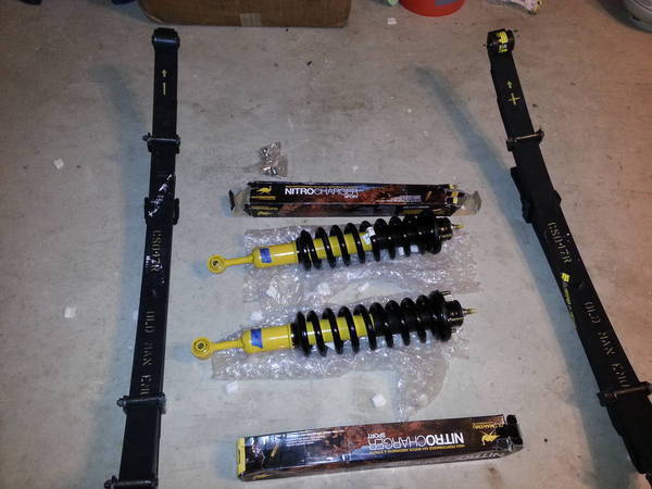

  12. Jun 17, 2013 at 10:41 AM
    #1892
    Sandman614
    Oct 26, 2010
    #45273
    35,894
    Tim
    Garner, NC/Boone, NC
    '06 SR5 Off Road
    Do you have dual batteries or a toolbox or other extra weight on the driver side?
  13. Jun 17, 2013 at 10:41 AM
    #1893
    OZ-T
    OZ-T I hate my neighbour
    Dec 15, 2009
    #27584
    50,582
    Peter North
    British Columbia
    Did either of your Dakars have a " + " or a " - " ?

    shibubba
    shibubba Well-Known Member
    May 2, 2013
    #103324
    86
    Calgary Alberta
    2013 DCSB 6spd. Lotsa stuff.
    Kings Dakars 285/75r16 duratracs CBI rear bumper blah blah
    Yes they both have + marks on them

  16. Jun 17, 2013 at 4:54 PM
    #1896
    bjboucher
    bjboucher Mama says Tacoma World is da devil!
    Aug 8, 2012
    #84371
    2,243
    Brad
    San Antonio, Texas
    Former 2012 DCLB 4x4 SR5 Texas Edition
    OME complete kit w/ 885s on Nitrocharger Sports, 1/4" spacers, Dakars w/ Nitrocharger Sports, LR UCAs, 265/70-17, Duratracs, G4 Elite tonneau, Weathertech Window Deflectors, Weathertech digital floor liners, factory JBL/Entune, rear differential breather relocate.
    They ended up giving me a mix pack.

    + on the driver's side
  20. Jun 17, 2013 at 5:16 PM
    #1900
    OZ-T
    Dec 15, 2009
    #27584
    50,582
    Peter North
    British Columbia
    In that case , add a 1/4" top plate spacer on your driver's side
