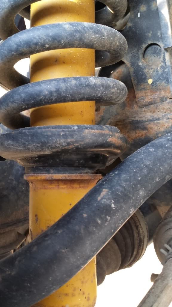

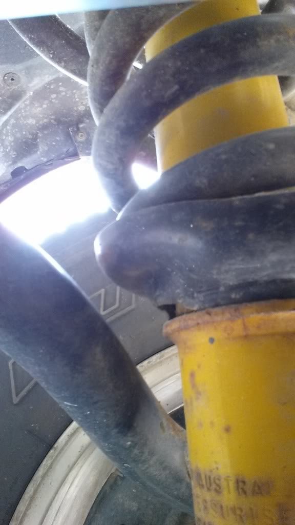

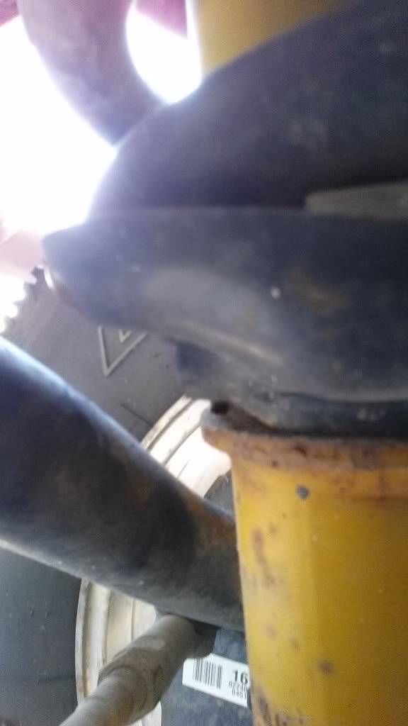

    I've had my OME lift on for about a year now. Since then, on 2 or 3 occasions I've heard a loud clunk in the front end when flexing the suspension and making a right hand turn. I couldnt figure out where it was coming from until today when I was under the truck just looking things over. I dont know the technical name of the part, (the metal bell shaped piece where the bottom of the coil sits), but the sway bar has contacted my suspension and bent this peice. It actually looks like the part has been pulled away from the shaft. Other than removing my sway bar, is there anything I can do to prevent this? Has anyone experienced this? Should I be concerned?

    You could get a sway bar relocation kit if you want to continue using the sway bar. It will help move it away from where it is contacting

    I dont think your coil seat is bent at all. Thats how it looks normally. There is a small rust spot where the sway bar could be contacting

    Sway bar relocates

    Wheeler's is sending me the Sway Away SAW 19920-1 relocate kit, I'm just going to install it with the rest of my stuff whether I need it or not. Seems like several folks are having this problem.

    Maybe the pics don't do it justice but comparing it to the other side, its definitely not the same and looks kinda jacked up. I put this lift on myself after 2 months of drooling all over the parts while they sat in my garage waiting to be installed - i know what they're supposed to look like. My sway bar might be coming off in the near future...

    True I tried to get the best pics I could but its on the back side of the shock and kinda an awkward spot to get a good pic. My sway bar is effed up
    http://www.tacomaworld.com/forum/2nd-gen-tacomas/218513-sway-bar-problems-ome-install.html
    Dont know much about the relocates, I'll look into them...but the second part of my OP on that thread explains what happens. Unless the relocates will work, my only option is to remove it or keep tearing up my shock :/

    That's the point of the relocate, it moves it so it doesn't contact the springs. I haven't installed mine yet but there's a thread on here about it....looks super easy and can be done at anytime.

    I got the ToyTec relocate bracket after installing the lift. I knew I'd need it before doing any flexing or else I'd make contact. Took me all of 30 minutes to install (I didn't have an impact wrench or it would have been more like 10 minutes).
