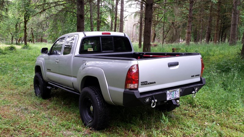

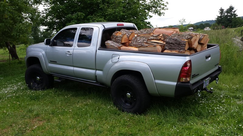

  18. Jun 4, 2017 at 7:03 AM
    #38
    Vacationgangster
    Vacationgangster Well-Known Member
    Sep 19, 2016
    #197746
    207
    2005 silver Tacoma
    OME 886's, Dakar Leafs, fk29 cb shim, 3deg spacers, 17" Method Vex, 255/80/17 Cooper S/T maxx, Leer shell, frontrunner rack, Thule bars, 40" light bar, Hids, Seat covers, JL's, Headunit
    ^^^ Looks like it's sagging like crazy. I know you have it loaded down, but looks a bit pre runner ish
    bluezzy likes this.

  20. Jun 4, 2017 at 8:33 AM
    #40
    bluezzy
    bluezzy Love My SuperCharged 07 Sport!
    Feb 3, 2016
    #177007
    2,259
    Monty
    Eugene, Oregon
    That load was totally green wood and on an uphill slant made it even look more saggy, she did pretty good out on the freeway at 60mph... here's what it looks like without the load:
