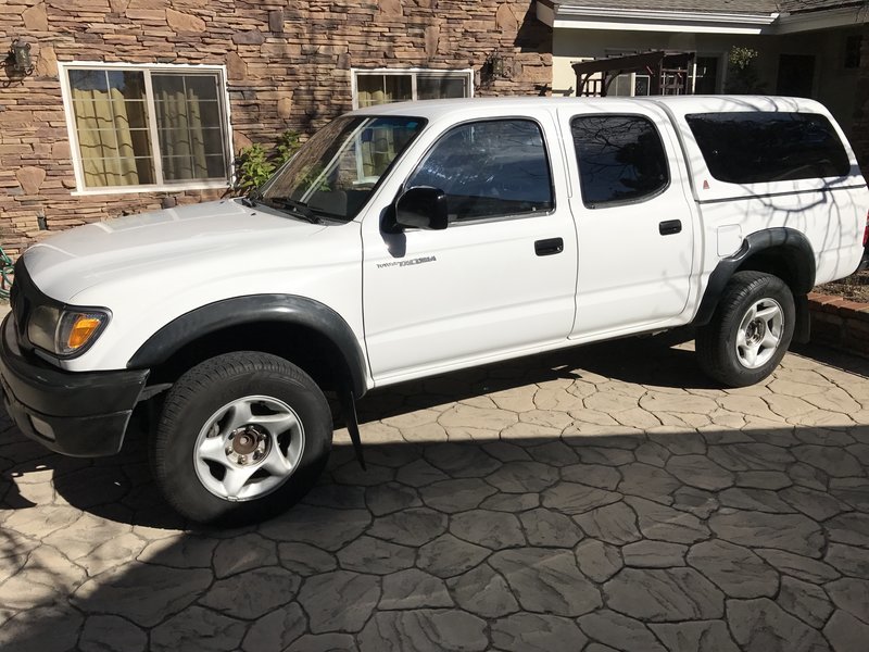

    I can't tell if mine is sagging or stock height
