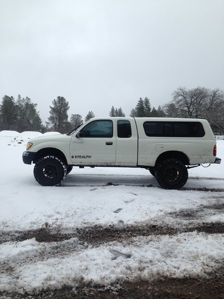

    dwaggs_
    dwaggs_ @dwaggs_
    Aug 5, 2016
    #193799
    88
    Donald
    Roseville, CA
    1998 Tacoma SR5
    285/75/16 Falken Wildpeak AT3 SCS Stealth 6 Icon Ext. Travel Coilovers Camburg racing UCA’s OME Dakar leaf springs Honda Prelude seats
    882 with dakars
