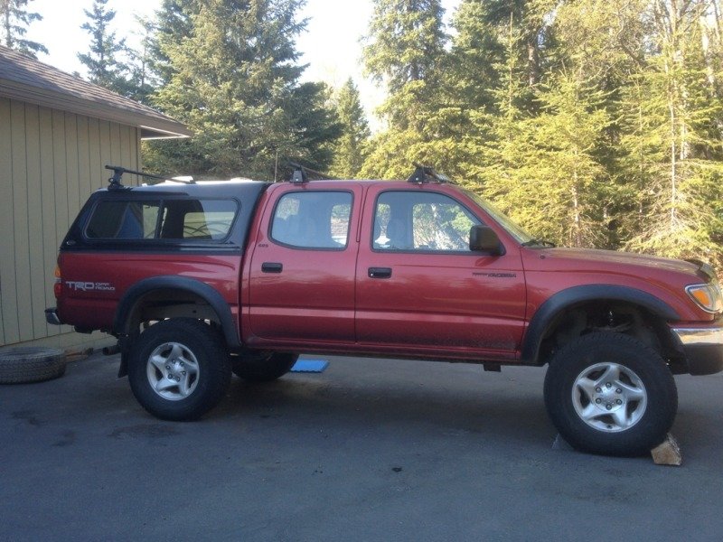

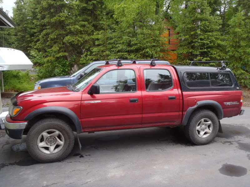

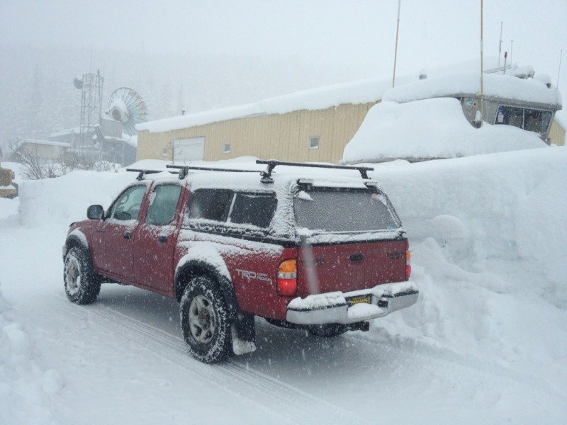

    Finally installed my OME kit. I went with 883s up front with Dakars w/AAL in the rear and nitrochargers all the way around. I've only driven it for a few minutes so far and it's in the shop getting an alignment and other work done. I'll get it back tomorrow and hopefully test it out more this weekend. So far the ride is WAY better than stock.
    I took some rough measurements from hub to fender before and after. Up front I gained almost 4'' :eek: Keep in mind that was with stock springs that were sagging. In the rear I gained 3.5''.
    I don't have great pics of before, but here's a few.
    Before:
    C0EA2281-1898-4E06-BC9F-ACDADDEA502E-307_31335801e5e2e474ecef88e4738e0eead8ce079e.jpg
    After:
    87137E26-FC88-4C00-8595-16BC067BD9FF-264_c2c49aecd3ab370e70cfe248c63384e82339b9c4.jpg
    09FB2F7E-7151-4D7E-9C63-034D790CEE35-264_93e2b7597fd1e1ba4b0540e115b1978d037d743c.jpg
    I don't have a good pic of my CVs but they are a little steep. I'm waiting to see if the coils settle a little before installing a diff drop. I really don't want to put one in if I don't have to. A hybrid or plate bumper would help that out anyway. But that won't happen for a bit.
    My tire size is 265/75/16 if anyone is wondering. I think it looks pretty awesome. I was worried the tires would look too small but I think it looks just right. I'd love to step up to 33s, but I don't wheel enough to justify that. I am planning on picking up new tires this summer but I think I'll stick to the size I have now unless I have a change of heart.
