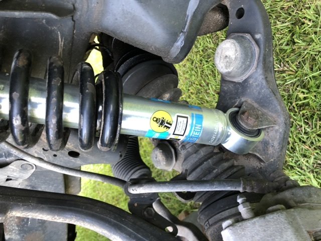

    Is it just me or are a lot of people running the spring perch upside down on their nitrochargers?
  6. Jun 16, 2020 at 8:27 AM
    #4566
    Tacoscar-the-grouch
    Tacoscar-the-grouch Well-Known Member
    Mar 22, 2019
    #287551
    317
    Josh
    North Idaho
    2001 Reg. Cab Tacoma
    OME kit 4.56's 235/85/16
    I think it would be very obviously wrong if the perch was upside down. It would not fit together very well. Do you have a picture of what you suspect is an upside down perch?
    This is the correct way:
    you can see that the spring sits in the perch. This would not combine well when reversed.

    Yeah, stock photos. Look at the bottom of the shock, the one in the photo has an extension below the shock body and the bushing, on first gens the bushing is welded right to the body, see in my photo.
    I’ve no experience with 2nd and 3rd gens, but I would be really surprised if that is how the perch is supposed to sit on those shocks. :notsure: Probably just dropped the perch on for the photo.
