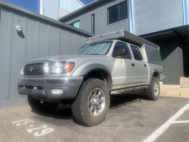

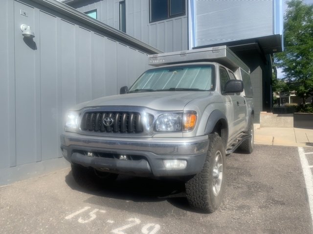

    These LT255/75R17 Load Range C's are nice because I dropped ~6.5 lbs per wheel/tire combo which is a lot of rotational weight over the smaller LT265/75R16 Load Range E...

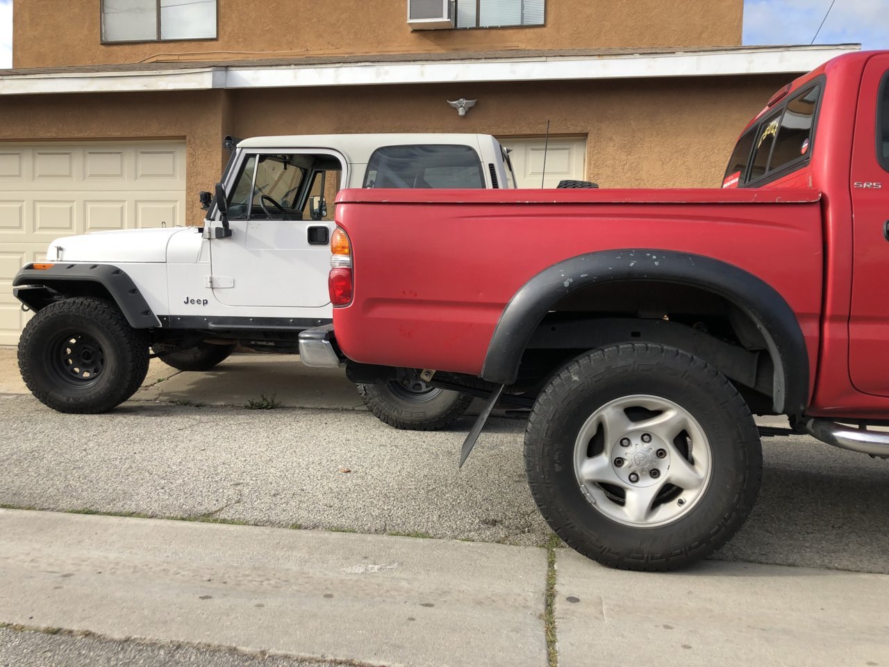

    In a similar situation as @Bluecord... Time for tires and really want to go the skinny route. Trying to save as much cash as I can but not really liking the options for 16's so Im leaning towards getting Fj 17's like @JasonLee.
    OME Nitrochargers all around, Dakar springs no AAL, OME Shackles
