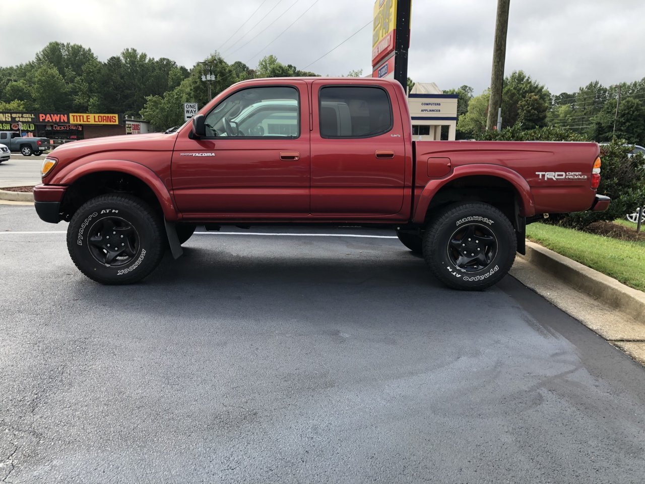

    So I installed my SPCs today (OME kit last week) and now I’m really noticing the driver side lean. Idk why it’s so obvious now and wasn’t so much when I installed the OME kit..
    Either way, does OME have trim packer preinstalled in all their coilver setups or does that depend? Definitely in need of a spacer. Pretty noticeable.

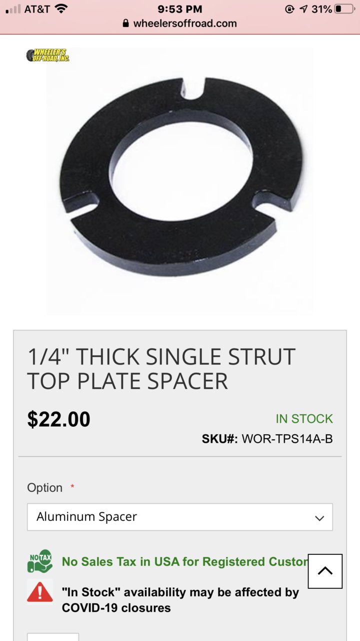

    Is this the correct spacer I’ll need? 6D3013F6-40A2-4C3E-B551-DC2C86B04EDA.jpg

    If you have enough stud to make a full nut on the three top hat spacer bolts.
