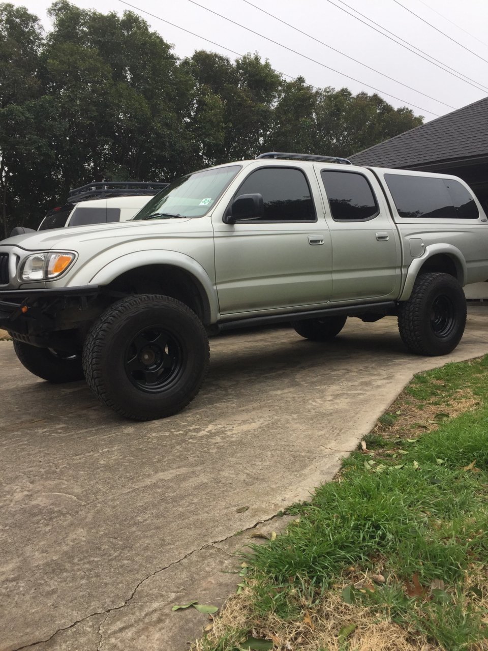

    looking good. I believe the leafs on the 98-04 settle better than 95-97. Throw some sandbags back there.

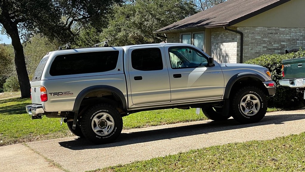

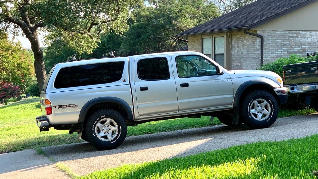

    Just finished installing my OME setup on my stock 2004 DBL 4WD TRD OR with a camper shell. I ordered the full kit from Wheelers with 2881s preloaded, and Dakkars with Add A Leaf for the back. Right now I have 265/75/16 KO2s.
    Thought some folks might like measurements... measuring from the floor to the bottom of the fender flare:
    • Front (5 days after)
      • Driver
        • Before: 35"
        • After: 37 1/4"
      • Passenger
        • Before: 35 1/4"
        • After: 37 3/8"
    • Back (1 days after)
      • Driver
        • Before: 35 5/8"
        • After: 40"
      • Passenger
        • Before: 35 1/8"
        • After: 39 3/4"
    A few notes from the install (these are probably noted somewhere else too):
    • Disconnecting the front sway bar made the front strut installation easier.
    • An angle grinder with a cutting wheel was used to remove the front leaf spring bolt on both sides. The 19mm Kobalt impact socket I used shattered trying to break one loose.
    • I ordered M14x2.0 100mm 10.9 hardness bolts from boltdepot.com to replace the bolts that were cut.
    • The bushings for the shackles come with a set of four chassis bushings in a bag and four leaf eye bushings in another bag. Don't do like I did and think that you have a set for the left in one bag and another bag with the right side bushings... they are different lengths!

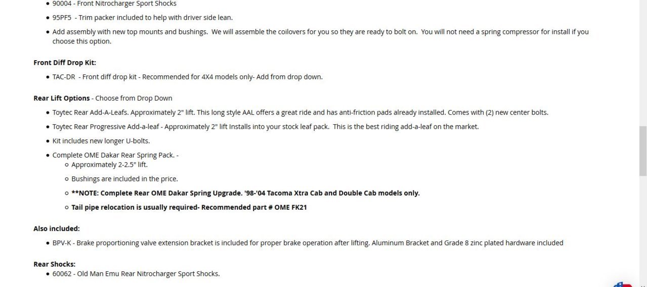

    That lift looks real good, but I thought the OME kit would level the truck? Toytec is selling the kit
    @SellyKlater can I get your input? If I want to be level, maybe I should just opt for an add a leaf instead of the Dakar springs?

    Not sure I can help much, I included the AAL with my Dakar's because of the camper shell and I did not want the truck to sag when I load a bunch of gear. It might be overkill. The front was about 3.5 " when I first did the coils but has dropped to about 2.25" in 5 days. I am hoping the rear leafs (just completed last night) drop an inch or so... I would be fine with about a 1" rake.
    My stock springs were frowning pretty badly at 160K. I thought it was probably just best to replace the rear springs.

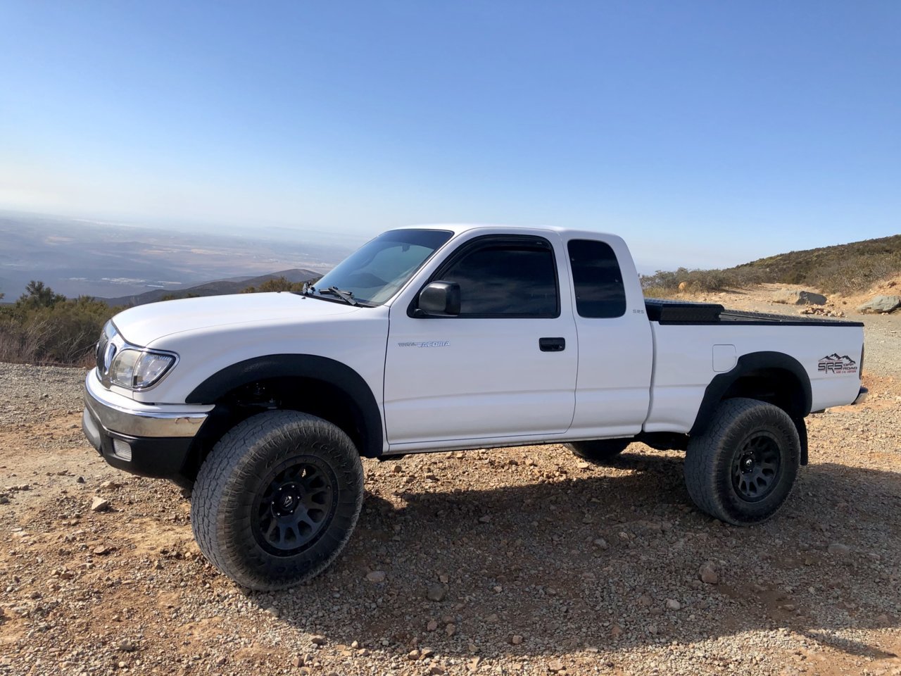

    Just went wheelin for the first time since the install. I think it handled VERY well on the trail. Felt pretty comfortable going across deep ruts n stuff. No hardcore flexing or anything but nonetheless happy with the outcome.
