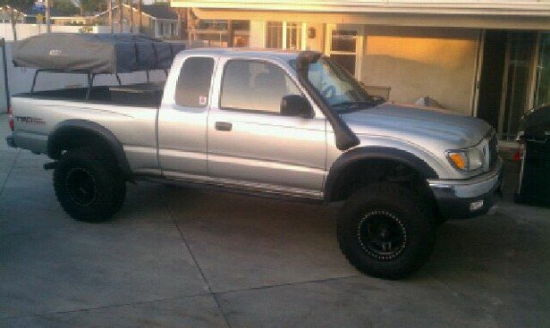

    OME 882/toytec 1/4 spacer with procomp AAL and I did the diff drop
    Palitaco510 and TacomaTyler_2002 like this.

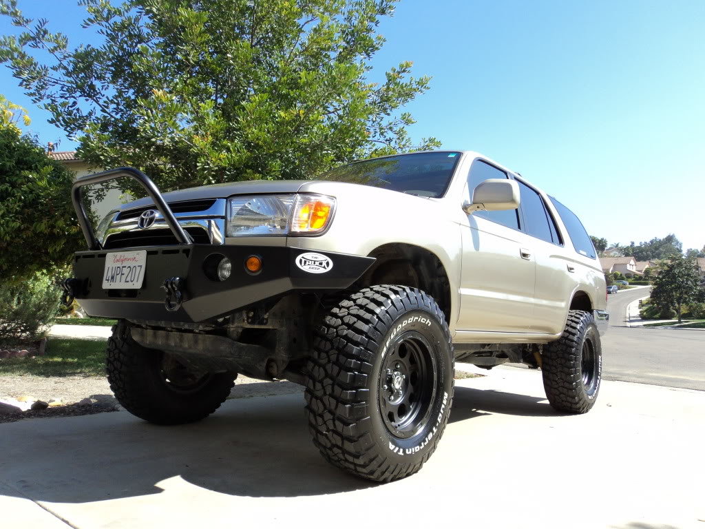

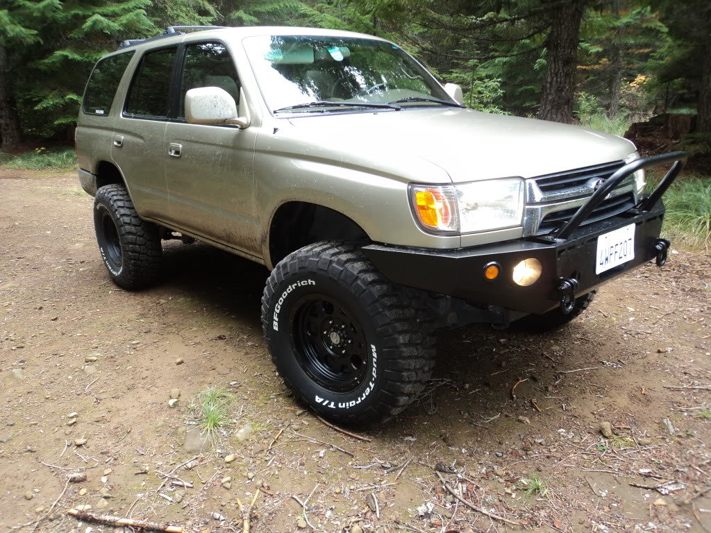

    2002 4x4 4Runner
    Stick on hood scoop from Autozone.
    Kind of a 1st gen. ;)
    OME set up all around.
    Front:
    OME 90004 Shocks
    OME 882 Coilovers
    Rear:
    OME 60027 Shocks
    OME 891 Coils

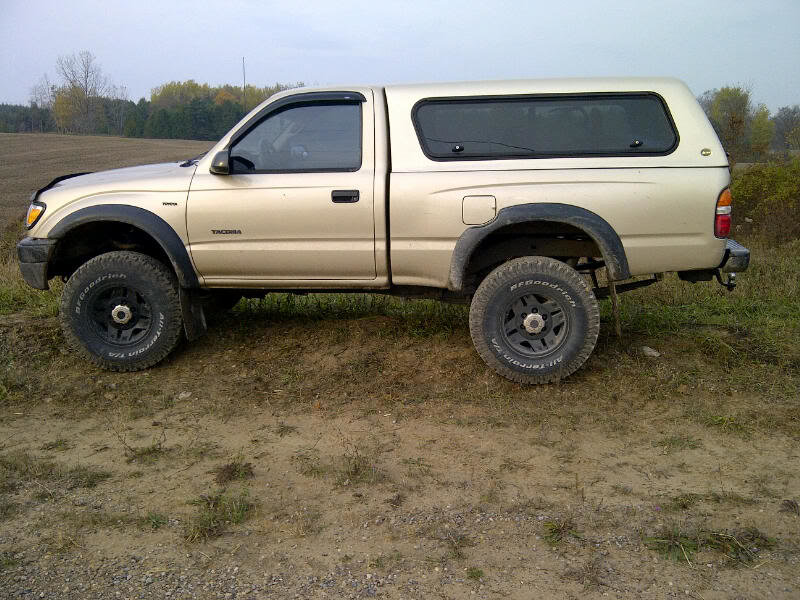

    Good point Boxrocket on the salt issues!

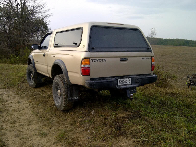

    Well I have had my OME suspension on since friday.....love it!
    Way more control...took her out and flexed a bit here and there carrying a 500lb load.....very comfotable ride when hitting some bumps hard!
    Unloaded I went up 2 inches in the front and 4 inches(bit high) in the rear. Looks way better with the load on....these gains were compared to the worn out stock suspension with 120,000 miles.
    881's and daker pacs with the AAL....keep in mind this is with a Reg.Cab
    Very happy with this OME set-up..thanks to all TW members who answered my Newbie?
    Post more pics soon.

    Here are a few pics from today after the bow hunt...straddling a mound at my parking spot....with a 500lb load.....loving the ride...OME is a great product!

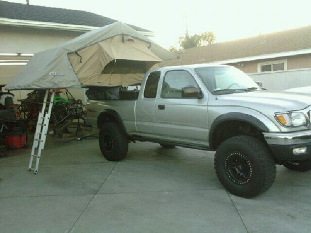

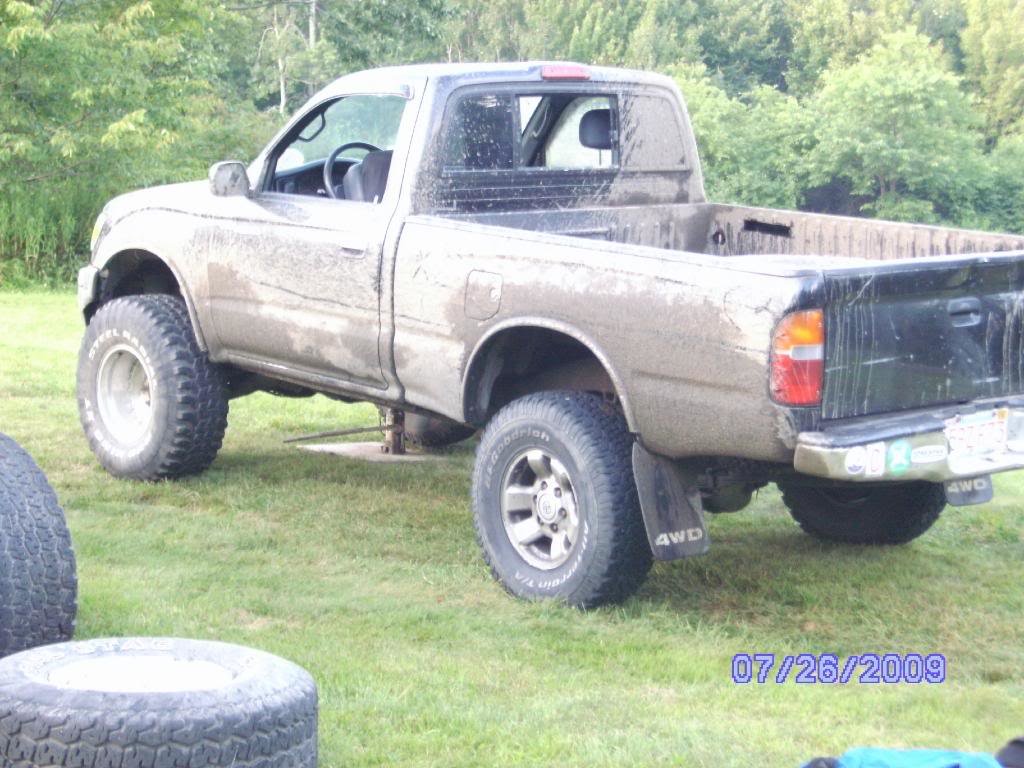

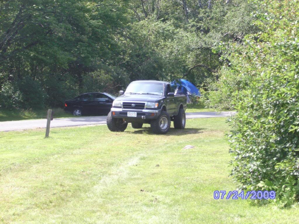

    I ran a full OME set up with 881's on my old truck and i liked it. It was pretty stiff for a couple months untill it broke in. (Offroading helps that). I was trying to find pictures of it but i only have pic from the last trip :mad: I had it on 31's when i found out toyota was taking back for the frame i borrowed 33's and went offroading with it:D I had no problems for the 5 or 6 months i had it on the truck before it got bought back.
    Tacomaman63 likes this.
  19. Feb 17, 2012 at 4:11 PM
    #199
    poseytaco
    poseytaco Well-Known Member
    Jan 5, 2012
    #70047
    747
    Nicholas
    Indiana
    2012 Off-road
    truck and i liked it. It was pretty stiff for a couple months untill it broke in. (Offroading helps that). I was trying to find pictures of it but i only have pic from the last trip I had it on 31's when i found out toyota was taking back for the frame i borrowed 33
    Thanks for the pics. Did you have the Dakar pack in the rear.?
