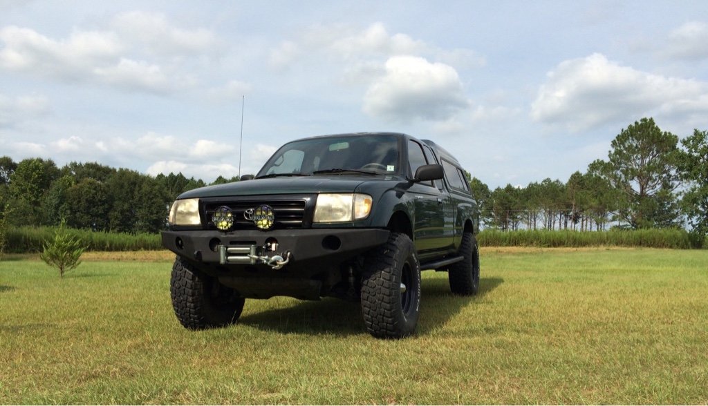

    I have an extended cab 3rz with 881s on 5100s and Wheelers 5 pack in the rear. I recently installed a plate bumper and it started to sag/droop/settle under the weight of the bumper. The bumper tips the scales right at 90 pounds. I had a HF Badland 12k winch sitting in the garage and I finally got it in the bumper last night. The winch manual has it almost 90 pounds, too.
    I PRELOADED the OME 881 coils on the second notch(1.25"). Initially I had some Carolina Rake, but I knew that wouldn't last because I had the LBJs off since Friday and the diff pulled working on several projects over the weekend. I pulled an all nighter last night to finish and had her back on all fours about midnight-0100. I pulled a measurement 15m ago and got good numbers. Late last night I had 25" from center cap to fender and most recently it was 23". Rear sitting at 23.25" both times.
    I almost went the 2.5" notch but some research steered me away after comparing motor weights and new hardware.
