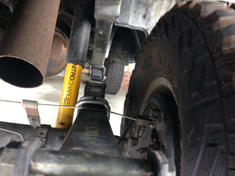

    Need some advice. I just installed an add a leaf (D43XL) for my dakers long with a relocation plate to move my axle further back and give me more load capacity. A few things happened after I did this install.
    1) My parking brake cable is now sitting on top of the leaf pack
    2) I can't install the factory bump stop due to the axle pin being pushed back
    Anyone run into these problems and what have you done to address them?
  7. Sep 16, 2015 at 1:59 PM
    #2087
    scocar
    scocar hypotenoper
    Nov 11, 2009
    #25814
    39,861
    1. You may be able to drill out the bumpstop to accommodate.
    2. There is a mod for the cable. You can see that you would need to extend the inboard cable guide brackets, which is pretty simple, just get some steel or aluminum stock, cut, drill, insert. At the outer bell crank connection, there is a specific little piece of angle iron to mod for that, I'll have to dig up the link.

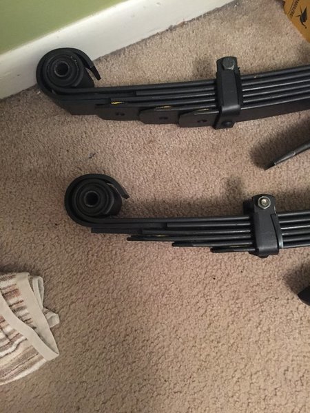

    Is this normal for the aal 3 leafs down to be the same length as the one above it? Its shorter on the back end only because its the wrap around leaf.image.jpg

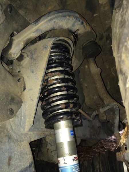

    I had a set of 5100s and OME 880s under a 2.7l. I also have a set of Wheelers 5 leaf springs. I added a 12k Badland winch in an Elite plate bumper so I moved up to the middle setting on the 5100s. The ride was rough in the beginning but has smoothed out. Today I tried to max out and see what the new limits were like this and here's what I found.
    The rear here is free. I was able to totter the truck with little force. The 5100 was nearly compressed in the front. I bounced up and down on the bumper and it was fairly solid. Maybe a 1/2" of movement.
    The rear is stuffed and there's a little more to go on the 5125, as I haven't put in longer bump stops. The front is limited by the droop of the 5100 at this point.

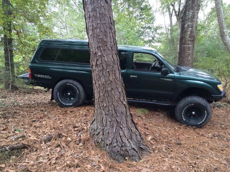

    I like your truck man, looks good. Is there a reason you installed your sliders backwards?
    ACKtrd30 and 2000tacobro like this.
  16. Oct 3, 2015 at 7:56 PM
    #2096
    Brake Weight
    Brake Weight But it hasn't rained in weeks...I'll make it.
    Jan 27, 2015
    #147363
    2,869
    Deep South near the Third Coast
    Taco pulling 33s and a B6 pushing 33psi
    Weld on sliders, fiberglass shell, 12k winch in an Elite Offroad bumper, front Aussie Lunchbox
    We measured it all out, mocked it up using jack stands, then in our inebriated haste to finish we marked and welded the legs starting from the wrong end. Did both sides on the bench and when neither lined up...almost shed a tear. Got mad and welded them to the frame backwards and called it a day.
