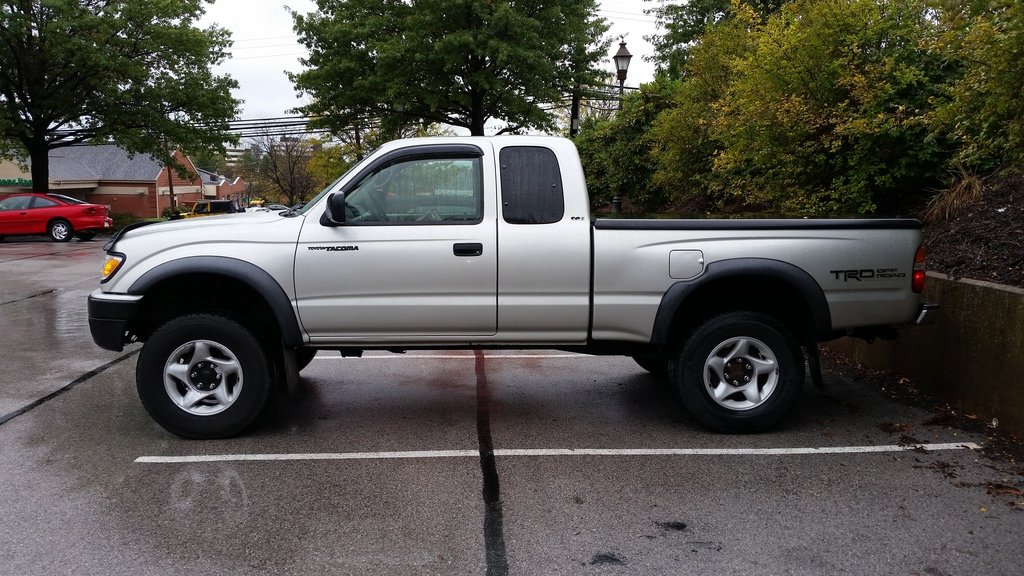

    @smoore, here is my recent full OME (881 with 3/8" spacer, Dakars in rear). I have about 120 lbs in the bed with stuff but the front to me is still too high.

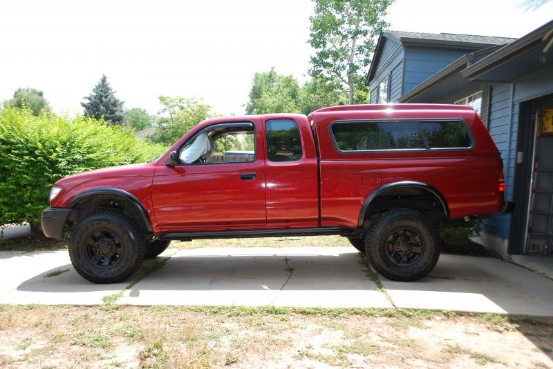

    Here is what 881s and Dakars without an AAL look like on a truck (01) with a cap right after install.
    Re: brakes: did you install a brake proportioning valve (BPV) relocaiton bracket on the rear axle? If not, with that that unusally crazy high rear rake, all your brake power is goign to the front rotors and could warp them.
    BPV relocated bracket generally looks like this:
    And goes here:

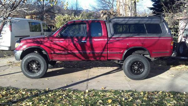

    This is mine right after 881 coils, 1/2" top spacer and Dakar leaves in back.
    The rake is not as bad because of the spacer.
    Scocar's lift is different because the newer years use a different set of rear springs that are longer and tend to sit lower.

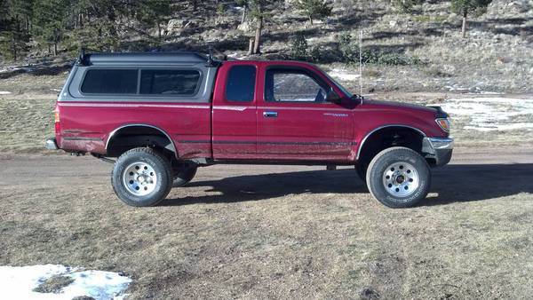

    Here it is again with bigger tires so the gap is better.
