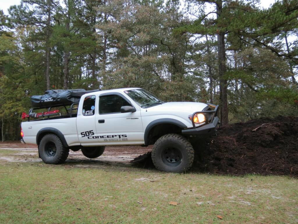

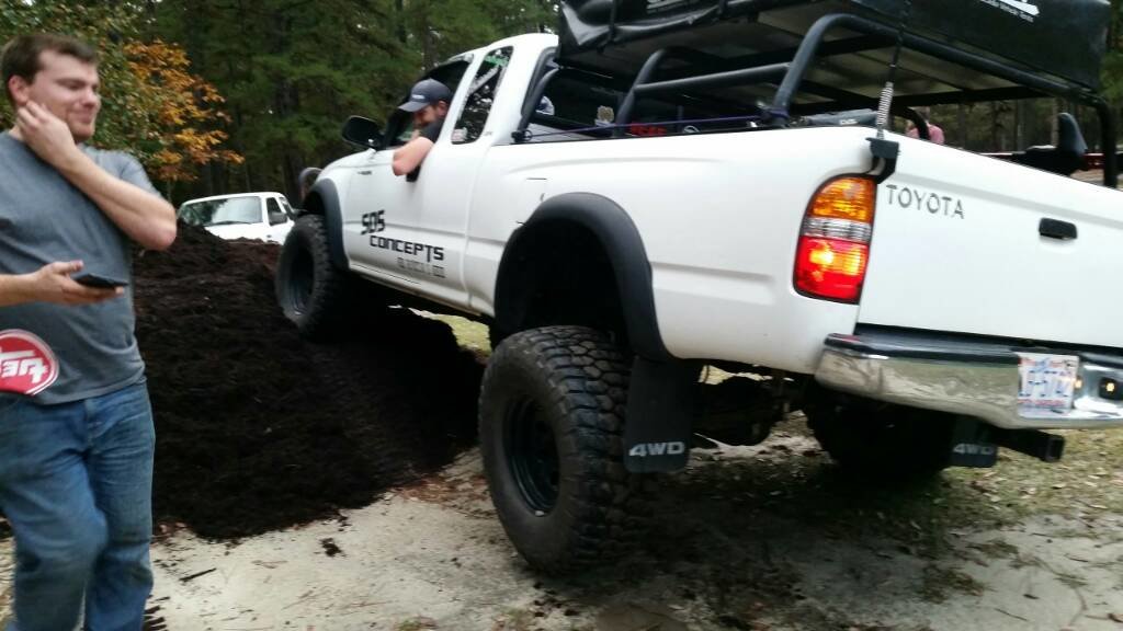

    Messing around Saturday.. thinking about getting some longer shocks :notsure:
    7952d7432156551b5bfa15a4b2f27f17_a4a93d85022c1bc2c2d80a30846abf30d1d17fe9.jpg015c985fd7cb6bcec25c89438a90a8c7_5d981ae71ebd36f294ee18fa7a49a9a8dd37b2b4.jpg72cb217f66f0c3d1cace98d185a29ea9_2a41b8b428e7db16a85c2e12a3b5cce7f0a93d47.jpg
    m3bassman and Deathbysnusnu like this.

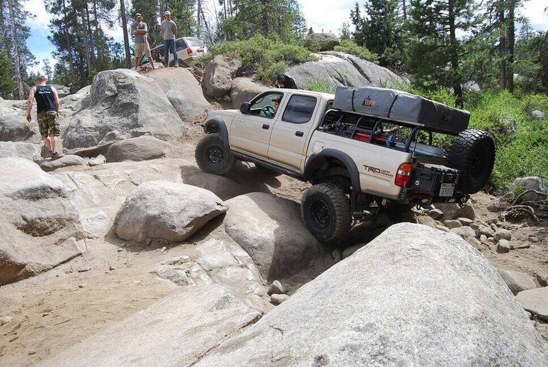

    Full ome lift, nitro charger sports all 4 corners (rear shocks relocated), Dakar pack w/ AAL, 882 coils, diff drop, toytec 1" shackles, trail gear low profile front bumper, Tuff Stuff winch, bamf sliders, RAT skids, BAMF Bed Rack, Tepui Kukenam RTT, RAT rear bumper,
    Mine were just relocated and it helped a bunch. I'm sure I lift in the rear sometimes, but doesn't seem near as often anymore:

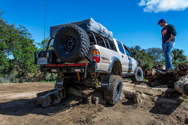

    I also relocated my shocks, still under the bed though.
    dont have any better pics, but the rear flexes well.
