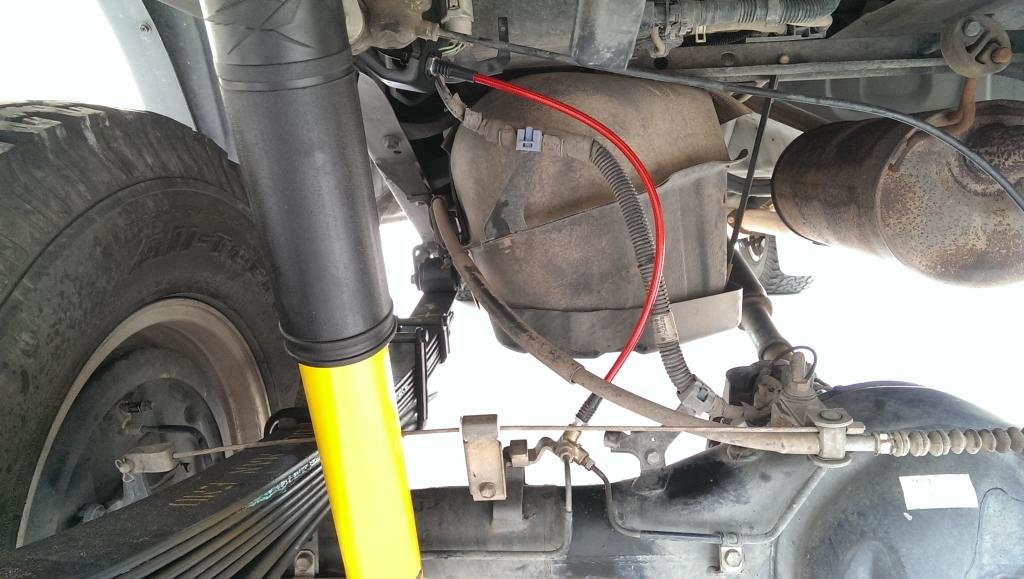

    Question about Wheeler's full OME kit.
    I did the install all around OME and Dakars with all the associated Wheeler's extras.
    I am left with the brake-line they provide and I am wondering - do I really need this?
    Can anyone give me an opinion? 2000 Prerunner. Thanks...
  2. Jan 3, 2016 at 5:19 PM
    #2182
    Brake Weight
    Brake Weight But it hasn't rained in weeks...I'll make it.
    Jan 27, 2015
    #147363
    2,882
    Deep South near the Third Coast
    Taco pulling 33s and a B6 pushing 33psi
    Weld on sliders, fiberglass shell, 12k winch in an Elite Offroad bumper, front Aussie Lunchbox
    If you ever do anything to flex the axle? Yes. I went a few months before doing mine and nearly pulled the line in two on several occasions.
    It's not hard to change out. You may as bleed all 4 brakes while you're at it, too. Get all that old fluid out and start new.

    I would as a precaution. Always nice to have it in case the rear ever gets a little stretched. Better than losing brakes :)

    I installed the longer line when I did mine. Just as a precaution. It helps a lot when doing the spring swap as well since you don't have to worry about the line stretching when you drop the axle.

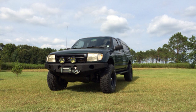

    Brake Weight
    Jan 27, 2015
    #147363
    2,882
    881s will do it. I'm running 881s on 5100s.
    Not the best pic, but you get the idea. 33s and Wheelers 5 leaf packs.
    Three years later I added a plate bumper and a BL winch. Moved up to the middle notch. 190-200# added.

    I am doing the wheelers 5 leaf right now and got the full ome kit.. I know what brake line the extra line they provided goes in, just not sure where?? anyone have pics? thanks in advance
  8. Jan 6, 2016 at 10:53 AM
    #2188
    bry838
    bry838 Well-Known Member
    Sep 3, 2014
    #137527
    2,403
    oregon
    '00 tacoma 2.7 4x4 reg cab 5speed x's 2. '01 T4R 3.4 5 speed
    Really? It just replaces the existing one....from rear axle to bpv thingy.
