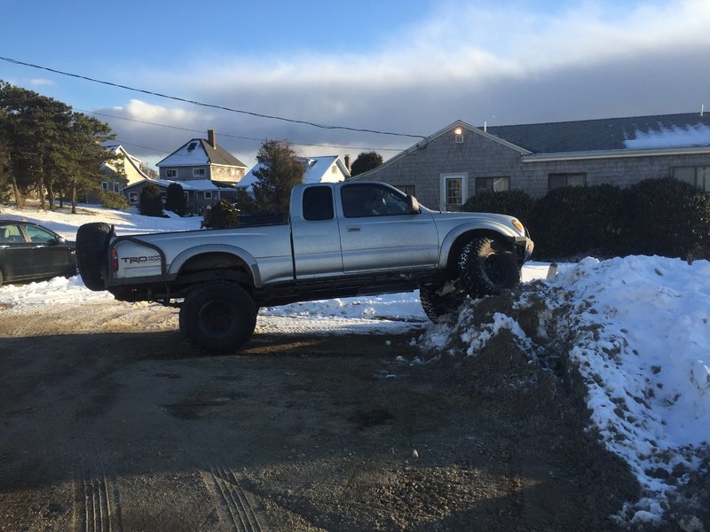

    Figured I would post up a 7 years later update. Purchased it in February of 09 and it has been in two trucks. First it was in my 98 reg cab
    Have the full kit with 881s. Wheeled it for years with no rear bump stops everything is starting to show its age but still works and rides well.
    Even with the plate bumper (no winch) front skid and 170lbs of homemade crossmember and crawler it still holds a fair amount of lift.
    Today
    Thanks New England!
    konarider1993 likes this.

    Thanks for posting this! I have OME 881's, dakar, and OME nitro's for all 4 corners sitting in my shed. Once I get a couple more front end parts I'll go ahead with the install. Probably early march.
    I'm keeping the front end light on my 02 and with the 881's I have, I feel better about front end sag after reading what you have.
