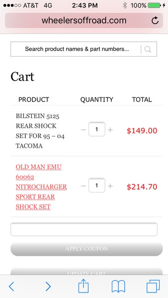

    I was just comparing prices. Got me wondering.

    I think the 5125s have a little more travel, but someone else can chime in. I have the nitrochargers and they do just fine.

    Does anyone think there is a significant difference in the two?

    Nitrochargers have ~9" of travel, 5125s have 10", 12", and 14" inches of travel. If you go bigger than 10" you are going to have to relocate your shock mounts.

    If I go with 10 do I still get the 3 inches of lift? Sorry... The wheelers website isn't giving me much.

    Should still get 3" of lift. I think the wheelers kit you linked is for 10" shocks. I was hoping someone else would chime in to give you some better info. If anything just give Wheelers a call to clarify.

    Just to clarify those wont give any lift! They just accommodate the 3 inch lift you're wanting...

    So they'll be the shock to use when I buy my AAL. Is that what you're saying?

    Right, theyre just extended length shocks to use when youve lifted the rear.

    I think I'm gonna get these 5125s, mainly just cause they are cheaper. Does anyone have any thing bad to say about this?

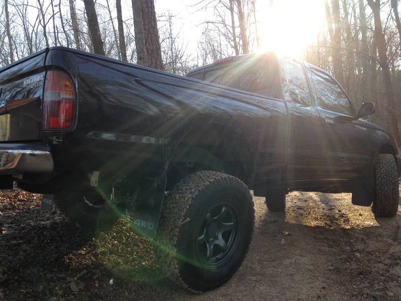

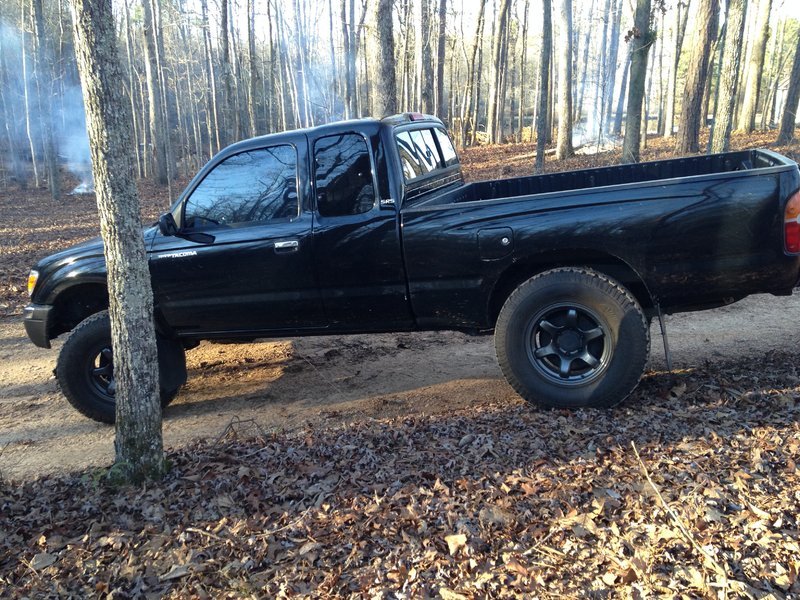

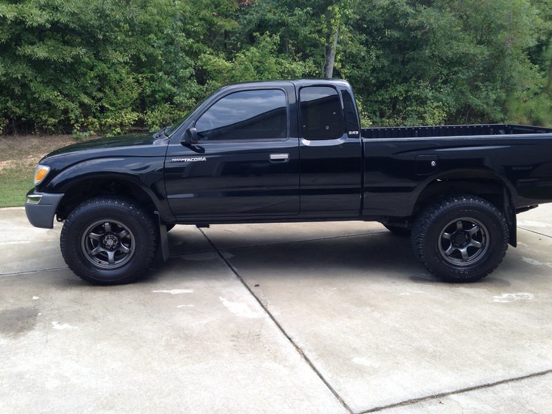

  16. Feb 17, 2016 at 10:27 AM
    #2236
    AviateGW
    AviateGW Well-Known Member
    Mar 28, 2010
    #34121
    77
    Glenn
    Atlanta area
    Black '99 3.4 SR5 4x4. OME/Dakar
    16x8 KONIG Countersteer Offroads from FN, OME/881s in front, OME shocks/Dakar leafs in back. K&N CAI, and last, but not least, TRD Shift knob.
    My OME setup: 881s and Dakars.

    I've got 10" 5125s with my wheelers 5pack and AAL. They have served my needs very well!

    I don't know if you know but, which one of these did you get? I have no idea for sure what I'm gonna need...

    Pretty sure I got the 33-185552 w/ the 255/70 valving
