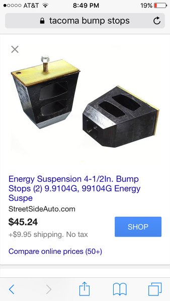

    I just got a brand new set of stock leaf springs from after doing some work for my uncle. That's why I'm stuck on the progressive. I'm just wondering if those bump stops are the ones I would need, I don't want to spend 250$ for fox bump stops right now...

    I'll definitely look into it. Would those ones I posted work too? Sorry for more questions everyone...

    Those ones you posted are too long. You dont need 4.5" ones...

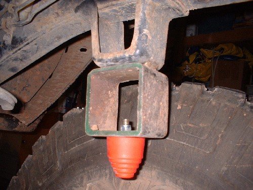

    @JKO1998 Here is kinda what i was talking about with the square stock. Minus that orange bumper deal.
    Id get a short kength of that in 2 inch cut it in half or whatever and simply bilt em on, there is even already a hole in that bump stop off of the frame to utilize, boom extended bump stops for 5 bucks!

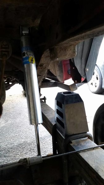

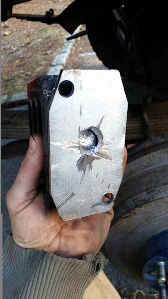

    Some lift, some armor, some scratches..
    These are exactly what I have. I think they look cleaner than doing the tube extensions but what's posted above works the same. I measured my flex/droop and determined that I needed the 4 1/2". You need to cycle your suspension after you install the AAL and shocks to figure out what length works for you.
    Here's mine; I modified them to fit in the stock location.

    @JKO1998 if you ditched your stock bumps those 4 1/2 inchers would be bout the right size. I think they are intended to go on the frame but i like the look of them on the springs like the last guy posted...
