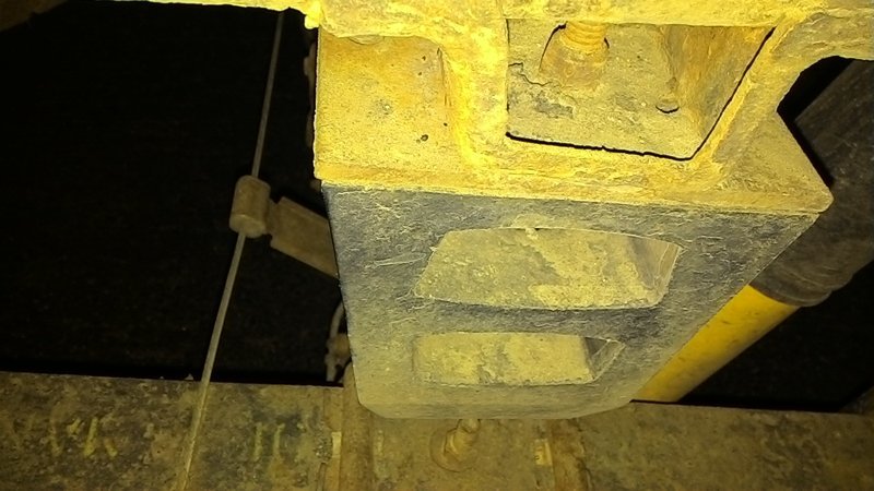

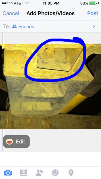

    Youll have to undo the ubolts and the stockers just come right off, the ubolts hold them on. And yes youll need to take the old ones off. You would end up with like one inch of trvel before the two bumps hit eachother if you left the stockers on.
    Would be easy to bolt on, just drill a hole or utilize the existing hole on the spot where the stock bumps hit the frame. The place where that square stock was mounted to on that pic i posted the other day. The new bumps already have a bolt and nut so you just need a hole to utilize and thats it, super simple.

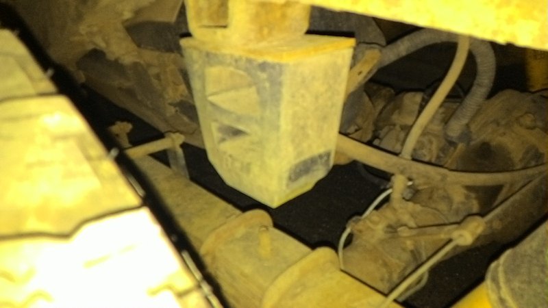

    Hey!! Perfect!
    By chance did you drill a hole in the new bumps for the center pin on the leafs to go into without it punching its own hole?
    Check it @JKO1998

    Ok so, the square piece coming off the frame that your bump stops are bolted to, those aren't factor bump stops? If they aren't I don't have bumpstops at all right now.
    Oh sweet -30$ off my lift. That's one of the few things I'll need help with when installing. What's the easiest way to take a pack of leaf springs about without blowing them up and riping off my head?

    Finally blew the motor at 230,000, sprung for a Jasper with 100,000/3 year warranty. The birdpig has a new set of wings! OME heavy load lift kit, Dakar leafs w/AAL, frame mounted energy suspension 4.5" bumpstops, 882 coils, nitrocharger sport shocks, trail gear sliders, addicted offroad front bumper, KC 130w daylighters, Warn M8000, 31" BFG KM2's, custom dents and Nevada pinstripes.
    No, the bumps have a deep recessed square pocket where they hit the leaf pack. I was worried about the leaf pin tearing the stops so I check it regularly and it seems to align properly. There are no abrasions or evidence of the pin hitting the stops.

    '00 tacoma 2.7 4x4 reg cab 5speed x's 2. '01 T4R 3.4 5 speed
    @JKO1998 you shoukd have the u shaped piece of steel hanging off the bottom of your frame rails, that piece is what comes into contact with the rubber bump thats on top of your leaf pack.

    Beat up 98taco 3.4L limited xtracab TRD
    The square bracket on the frame is what the factory leaf mounted bumpstops are supposed to contact. Our factory bumps are worthless little 2" cubes, mine disappeared sometime in the early 2000's. I just drilled a hole in the frame mounted bracket and put the new ones overhead.
    @JKO1998 did you see the two pics stumblestacks posted? Surly youve still got the original u shalped deals off the bottom of the frame the stock bumps come in contact with....

    Utah
    Yeah I have those just not anything on the springs. Or off of those.

    Utah
    I have these.
    Yeah even stumblestacks had lost his original rubber ones on his leaf packs, it happens...so just get the energy bumps mount en to the bottom of the frame like in stumbles pics and you be good to go my friend!
