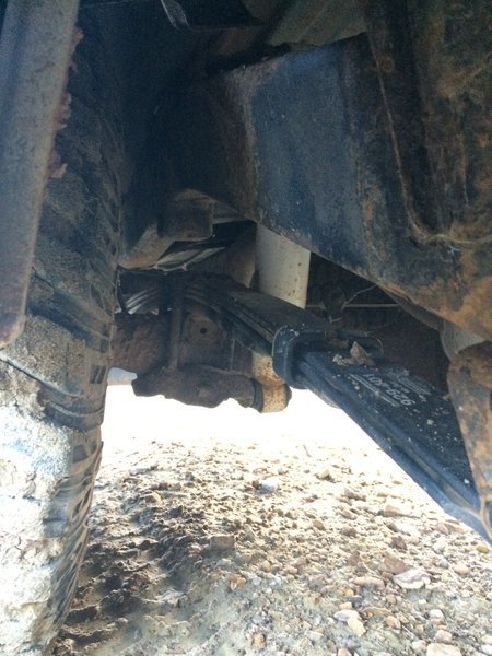

  7. Feb 26, 2016 at 4:19 PM
    #2327
    JKO1998
    JKO1998 Well-Known Member
    Jun 2, 2015
    #156578
    52,891
    Utah
    So i think I understand the need for bump stops now.

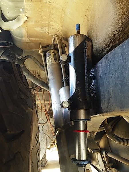

    [​IMG] I like bumpstops

    What did your shocks look like when you did this?? Way over extended? Bottomed out? Be careful when doing that, dont wanna mess up the shocks. Granted they are the old ones though still right?
    Are thise your new springs? Was the install pain free, no seized fasteners?
  11. Feb 27, 2016 at 6:47 AM
    #2331
    JKO1998
    Jun 2, 2015
    #156578
    52,891
    Utah
    My shocks are really crappy auto Zone stuff. Fully extended and compressed. I'll be honest with ya, I didn't install them, my uncles mechanics did. They said it was really a pain in the ass, I think if we would sprayed something on the bolts to make break loose easier it would been 100x easier.

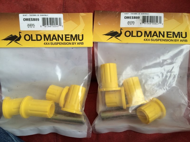

  17. Mar 2, 2016 at 11:04 AM
    #2337
    Trapperr
    Trapperr Well-Known Member
    Mar 6, 2014
    #124720
    1,002
    Reno, NV
    2002 Tacoma Double Cab 4x4 3.4l V6
    Also, what I thought was my bpv relocating bracket is actually an exhaust bracket which I don't need. Guess I'll have to fab something up.
    When I put these on I plan to coat the leaf spring hanger bolts heavy with anti seize. Would anti seize work better than grease for coating the bushing for the spring eye as far as longevity of lubrication!
  18. Mar 2, 2016 at 11:44 AM
    #2338
    WheelInTheSky
    WheelInTheSky Ramblin' Man
    Mar 4, 2015
    #150086
    5,204
    G
    Jackson Hole
    02 XtraCab 4x4 SR5-speed
    Each packet contains the bushing you need for one leaf pack. The two smaller bushings go in the rear eye of the leaf pack. The two large bushings go in the top eye of the shackle (through the frame.)
    The exhaust hanger relocate is F-something. The BPV is needed and both cheap enough to be worth buying and simple enough to be fabbed easily by most persons.
    You can put a lite coating of synthetic grease on the bolts to help get them through the bushings. Keep in mind that the bushings you have are for non-greaseable shackles. They are designed to work without grease.
    Edit: Exhaust Hanger relocation bracket is FK21
