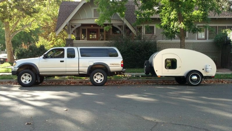

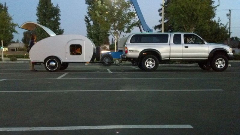

    Here is my old V6 with 881s, 5mm trim packer on driver side, and Dakars, no AAL. Stock tires size 265/70 16. Pic taken last September right before I sold it. Cap lived on it 24/7/365 since I bought it in 09. Towed a ~1600 lb camper and bed full of camping gear.
    881s had been on since late 2010, IIRC. Dakars since early Sept 2014. I swapped them in after the Wheelers 5 "HD" pack sagged out after only 4 years. That pack is not worth the high price AT ALL. At least I managed to resell it for $100.
    This is with the bed empty and trailer dry
    This is heavy camping load en route to Utah.

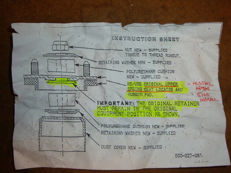

    Hey, Got a question for you guys who assembled your OME struts-
    I had a local 4x4 shop assemble the 880 coils onto Nitrocharger struts-
    The bottom metal cushion retainer rattles around, and has about 3-4mm of vertical play on the shaft of the shock, and the dust cover is loose and rattles around too. I'm skeptical that the shop assembled the stack of cushions and retainers correctly. Additionally, the eyelet is not properly aligned to mount to the lower control arm, and the shop guys said to torque on the eye to achieve alignment. Again, skeptical.
    Any input is greatly appreciated. Thanks

    Check Build
    Have any pics?

    Not sure if this is helpful, but this is the loose retainer:strut1.jpg
    It can move several mm.
    Thx

    Any pics of the bottom spring perch?
  18. Mar 22, 2016 at 11:32 AM
    #2358
    fella
    fella Member
    Dec 6, 2015
    #171546
    12
    2002 Single Cab Tacoma 2.7L 4x4
    Here it is:s1.jpg

    Those assembled struts look fishy. The pics aren't the greatest, though. Better camera possibly?

    Didn't they come with these instructions?
    My red notation is because I had 5100 on before the 881s, and I had a missing piece (highlighted retainer) I had to order from Toyota because they guy who installed the 5100s previously must have discarded it and not given back to me. I was not happy.
