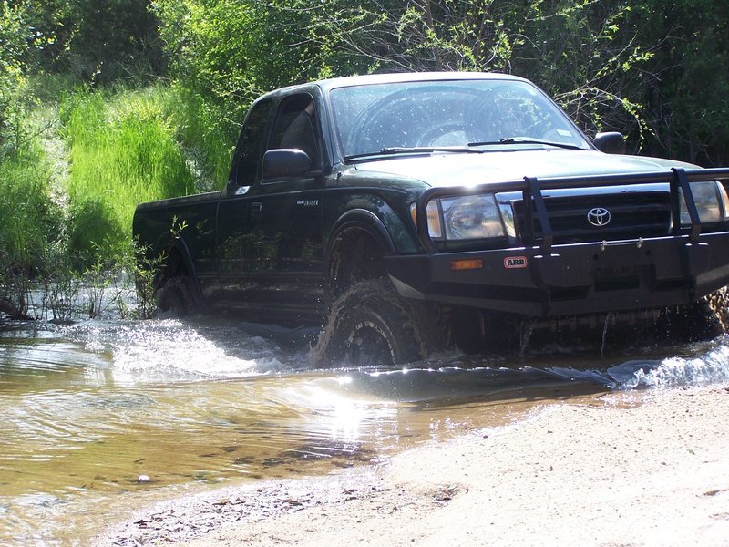

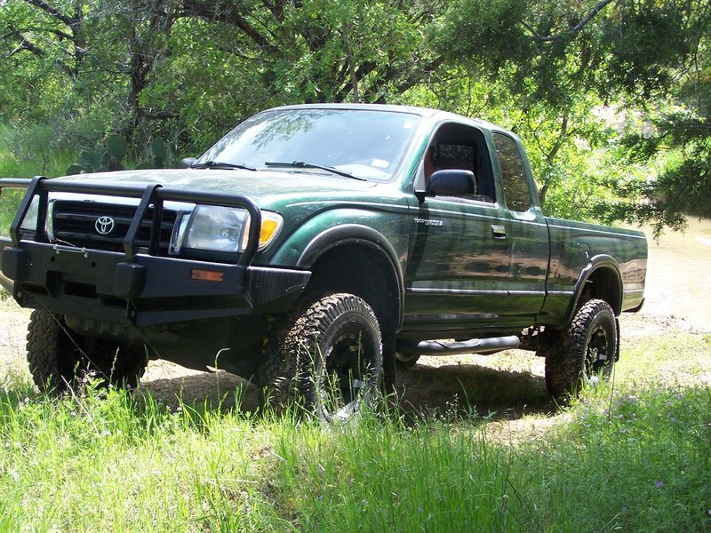

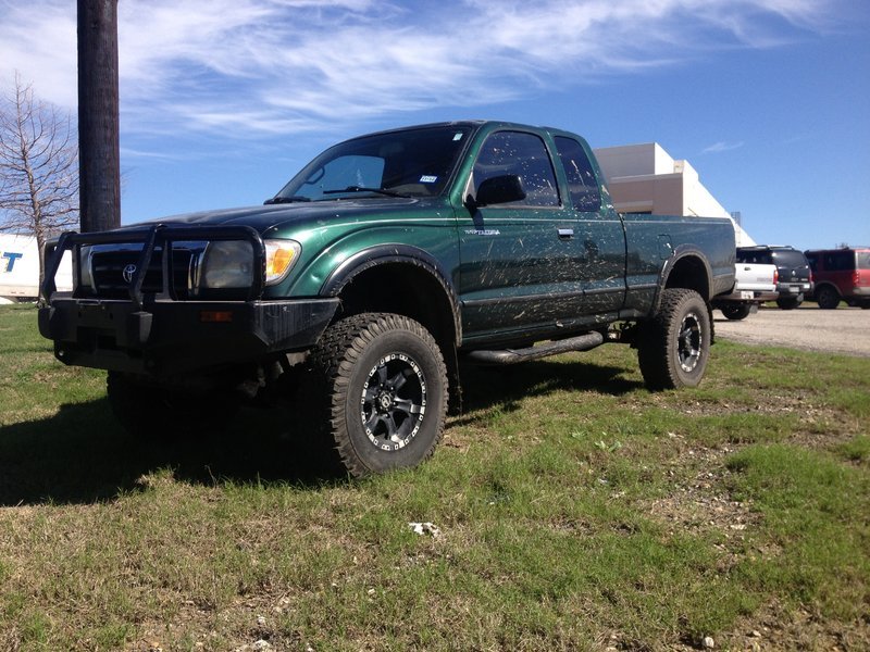

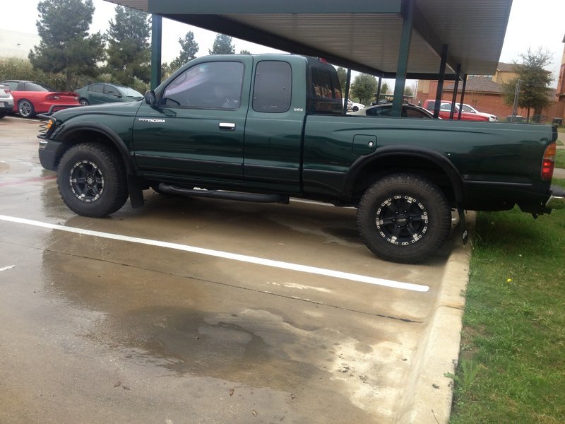

    I have a 99 extra cab 2.7 4wd. I just put the full OME kit on about a month ago. I think I should have went with the 881's because how it sits right now is about an inch higher in the front... Not what I was going after, but I'll live with it and find a way to raise the back end to leve it out once everything settles out. The only reason I went with the 883's was due to the fact that I have an ARB front bumper, and will be adding a winch shortly. Does anybody know if it will settle much once I put the winch on?

    It wont settle much...put your weight on the bumper, it wont move much at all.
    In that bottom pic it looks like the rear is higher than the front? You can always get a one inch block for the rear, or wheelers sells stackable plates that you put under your leaf packs to add little bit of lift or correct lean. Those are easy options to consider if u need more height in the rear.

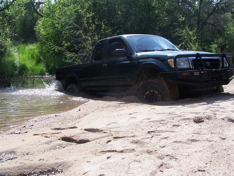

    Looks like you have locking hubs, which is good. Because that looks like an enormous amount of lift for just coil springs. Those CV angles must be very high.
    Does it bind any when in 4wd?

    I was noticing this weekend when I put it in 4 high it was sluggish, and seems like it wanted to stall going up steep hills. Is that what you by binding? I had a diff drop put on at the time of installation. This seemed like more lift than I was going after for sure with just the coils

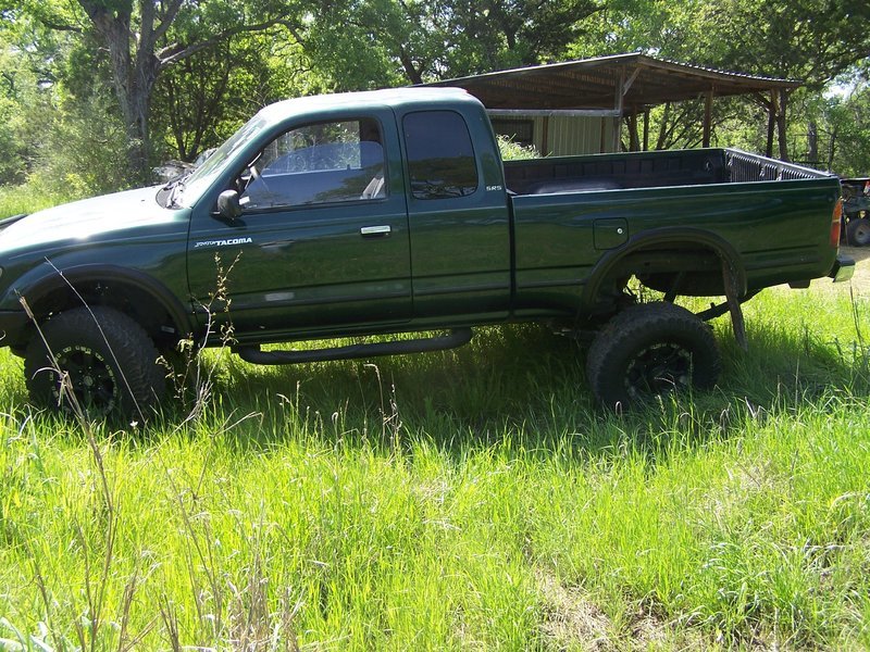

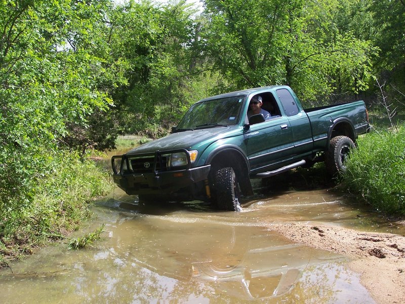

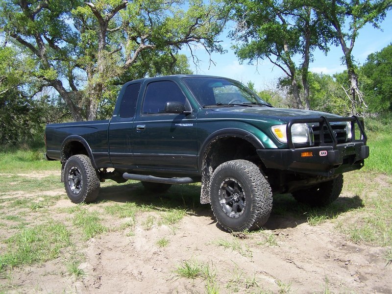

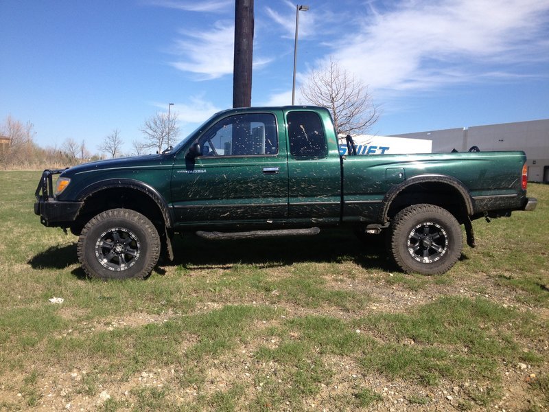

    I got off the phone with Steven from Wheelers a little bit ago and he said that once I put the winch on it may drop it and settle it out a little more. I'm gonna put the winch on and let it ride for a month then go from there. The winch will weight 80lbs, so it may. If not I'll throw and AAL in with the Dakars (I went with the Dakars only) and get the height dialed in and leveled out. This lift made my 31's look a tad small... The ride is good though, it's a little bit stuff but definetly feels grounded. The stock suspension was all over the place. I took some good pictures of it this weekend while doing some wheeling at my brothers, I'll post them up once I download them off my camera
    I don't have the before measurements but right now it sits
    Front driver-24.5
    Front passenger-25
    Rear driver-24.25
    Rear passenger-24.5
    Here is a before picture
