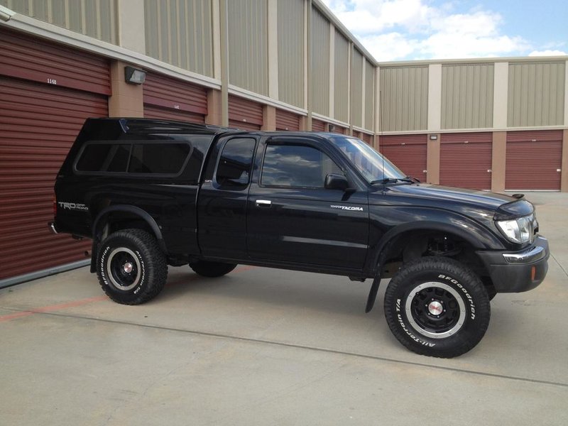

    So I got full OME setup, 883s and Dakars. After about 1,000 miles, I have not particularly enjoyed the stiff ride. The 883s have settled some. My 99 Tacoma v6 extended cab has 235,000 miles and had the original suspension and shocks on it. I have a Shrockworks on front and a ARE bed cap on back. I thought the ride would improve after replacing out the dead suspension.

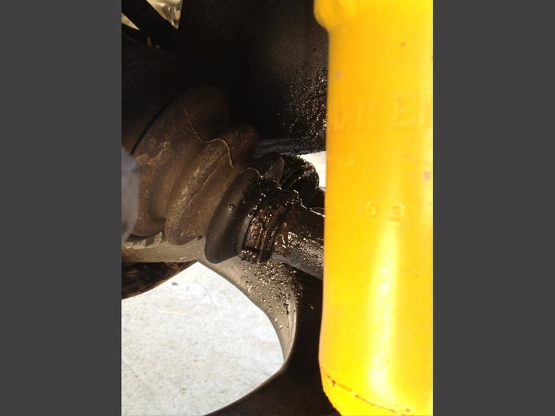

    The kicker....I looked under my rig today, and it appears that both CVs have blown out. I am thinking the 883 are too much. Thoughts?

    Not sure what I would do about the ride...I never thought the ride was too stiff when I had OME in the front. I have Kings now though which are superior.
    As for the blown CV, you need to put a dif drop kit in if you haven't already.

    here is a shot same day the OME was installed. 883 coils, dakar springs, nitrocharger shocks all around. no trim packers.

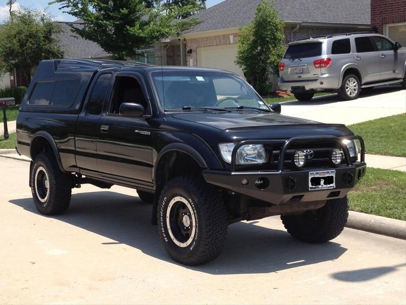

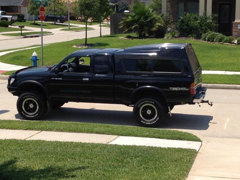

    full OME: 883s, no trim packs, dakars, OME hangars, nitrosport shocks all around...diff drop and AAL on its way.
    1) front view after shrockworks install
    2) side view with shrockworks
    3) CV boot that belched

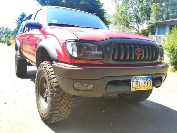

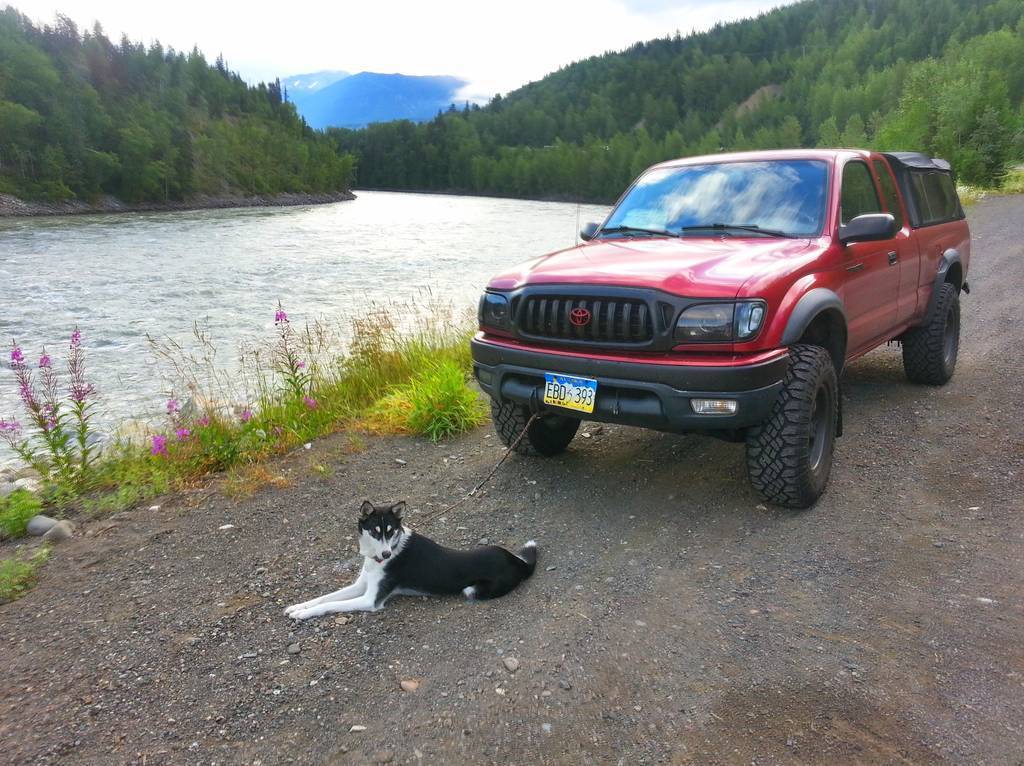

    OME 881's, Nitrocharger sports all the way around, and dakar's... Have the trim packer but it's not installed.
    Couple shots from the Front:

    I'd just like to say thanks to this thread, this forum, and especially box rocket for steering me in the ome direction. It's like an all new truck and it handled the 2400 miles like a god damn champ! Especially considering some of highway 37 north through canada and the yukon were beyond terrible.
    Before and after shot :
