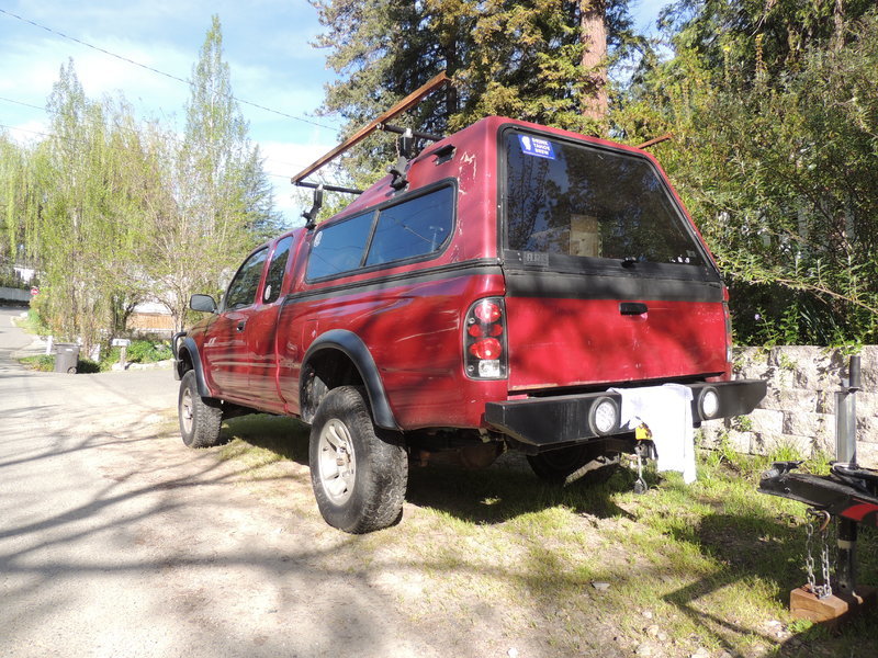

    Nice pics! Boy that poor taco has seen lots of hot hot summers in the heat hu? Also looks to be gettin pretty deep in the sand there...haha you were already needin that winch hu!?
    With those pics you posted i see you do have a good lil front rake goin on. I still dont think you will see enough "settling" with a winch in there to bring you dead nuts level front to rear. You'll prolly need to bring the rear up a tad... since you got the Dakars that'll be perfect to utilize the matching AAL's to bring you to level!

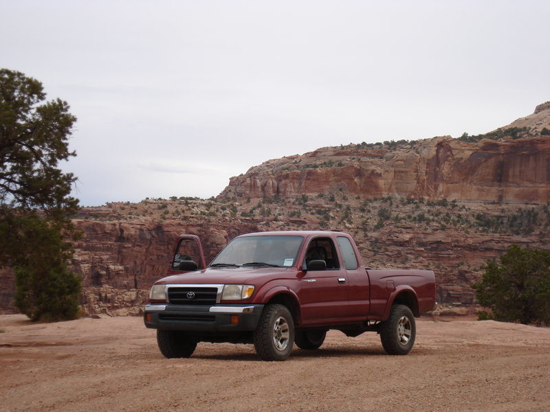

    Stock Alloys w/ 31.5x10.5x15 (Previously Black Pacers w/ BFG KM2 32xx11.5)
    Great pictures, thank you for posting. I really love my 2.7L even though its slow. It gets the job done and I can get it to sip gas when I need it to. I'm looking forward to the lift soon. Just need to be patient while fulfilling the honey-do's...

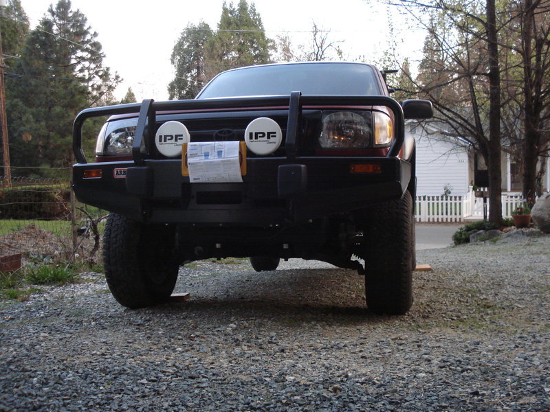

    Here is my 98, day after purchase used and somewhat abused
    New ARB bull bar, and 883 OME coils with Bilstein 5100s
    Full rear Dakar pack with AAL, and Bilstein 5125s.
    Coming along

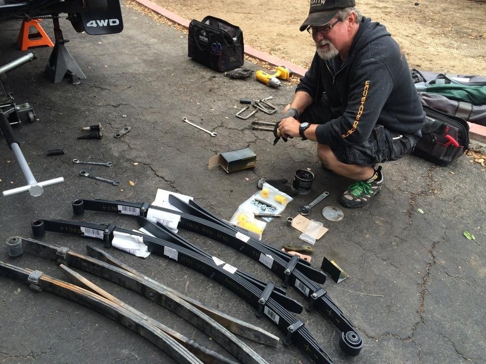

    Hey guys, I just bought a used OME lift for my 99 4x4 xtracab v6. It came with the 883 coils and dakars with AAL. Should I try running this setup (I don't have a heavy bumper or weight in the back), or should I try and find some 881's and remove the AAL from the back? I'm just worried that without the extra weight pushing down on the 883's I will have limited down travel.

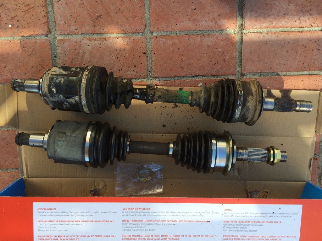

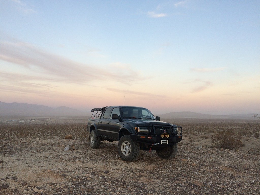

    Sooooo...one year ago today, I installed my OME lift on my 2003 DC 4x4.
    883's up front with Nitrocharger shocks, and Dakar HD's in the rear with NC shocks there too.
    Have put approximately 12,000 miles on the lift, and been very happy with its on and off road performance.
    The truck has been to Zion NP, Anza Borrego 3X, Death Valley for 5 days, and a host of other road/off road trips.
    Impressions...
    Once I got the proper weight for the 883's onto the front end, I stopped chewing half axles like oxies....which is nice.
    No vibes in the rear...so no issue there.
    The 3" of lift in front without the bumper and winch took about 2 months to tear the CV's, and 6 months to destroy the actual inner CV's (cause I couldn't "afford" the bumper and winch all at once) My mistake...which facilitated this trail repair during our DV trip in November of 2015...
    Moral of the story...respect your 3" lifted half axles.
    Also, installing a BudBuilt front skid set the ride height to perfection.
    (ARB Bumper + WARN M8000 winch)BudBuilt skid
    OME 883's + Dakar HD's = forumula for ride height bliss
    As she sits today...

    What was your lift ride height without the armor, and what is it now that you feel like is "height perfection"?
    Just curious b/c if you're still at 3", then why does it matter if you've got the armor or not, for the CVs, etc.?
  19. May 9, 2016 at 9:18 AM
    #2399
    geoyota760
    geoyota760 Allergic to pavement
    Feb 8, 2015
    #148201
    699
    PHOENIX, AZ
    2019 TRD OR
    5.29 Nitros Bilstein ICON Kansei BFG
    Well, truth be told, I never really measured anything before or after.
    Irresponsible forum behavior...I get it.
    Another irresponsible move was using the word "perfection" in a forum thread...polarizing term there, especially when I didn't take the time to measure "before and after."
    I suppose height perfection is defined as what Wheeler's Off Road recommended when I bought the 883 coils (which I understood would give me about 3" of lift), which was to install a steel bumper and winch to offset the extra lift which "might" affect the performance of my CV's...which it did.
    Also, visually, my truck sits level to my untrained eye.
