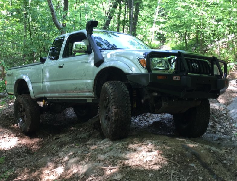

    #2401
    geoyota760
    geoyota760 Allergic to pavement
