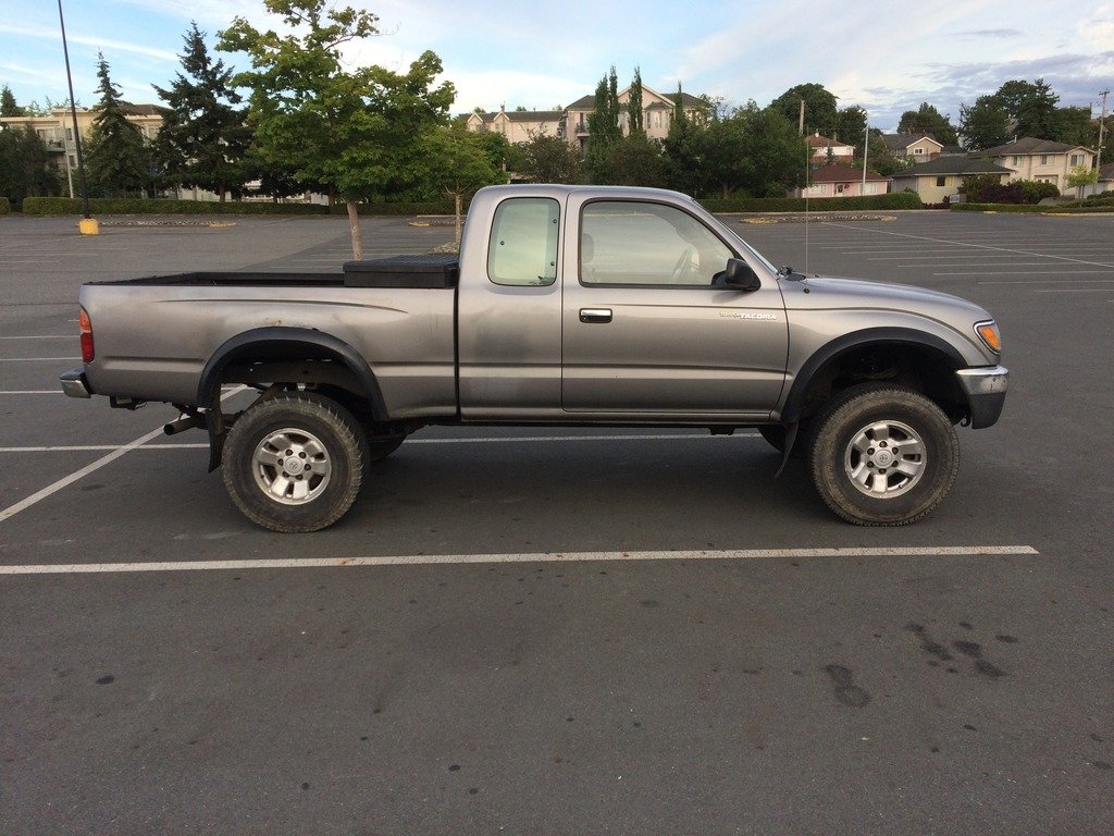

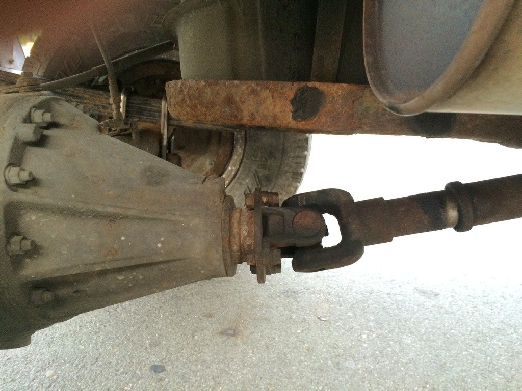

    Hey new to the forum, seems like a good website! Just installed some used ome cs019r springs and 881s up front with 5100 shocks all around. Going to put 33x10.5 15s on in from my other Toyota pickup. Just wondering what you guys do to correct driveshaft angle? Axle shims or driveshaft carrier bearing spacer

    95.5 OME
    I bought some 3* axle shims from wheelers off-road when I installed my CS019r springs. My angles look a bit better than yours but i could have gone with a 4* or 5* is my guess

    Start with a 4° axle shim, you want that shaft straight with the pinion. If the 4° shim isn't enough, then drop down the carrier bearing until it is straight.
