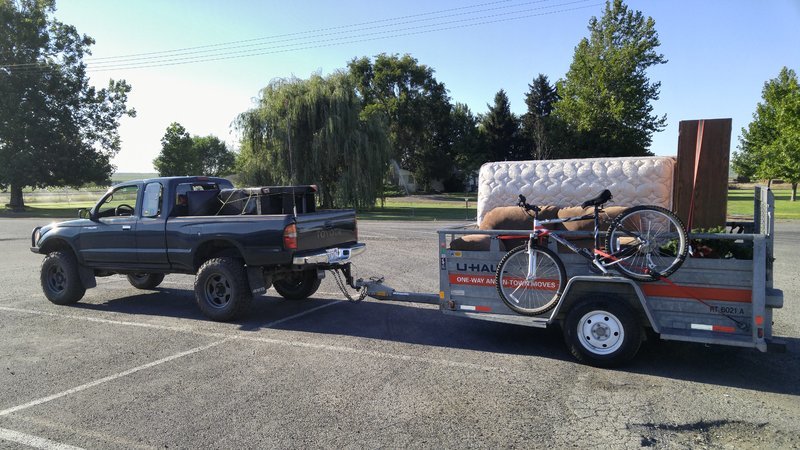

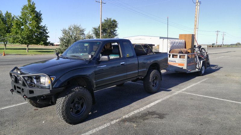

    It's less Tacoma and more mod
    So the four cylinder can tow... Lol

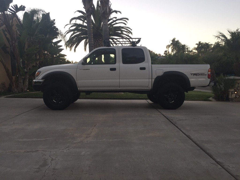

    I really like your setup. I'm thinking of doing the exact sa me thing. Does the truck sit pretty level? I want very little rake. On yours, it looks like there isn't any rake at all

    Now that everything has settled, there is a slight rake, the front may be 1/2" lower max. I'll try and get an updated picture soon

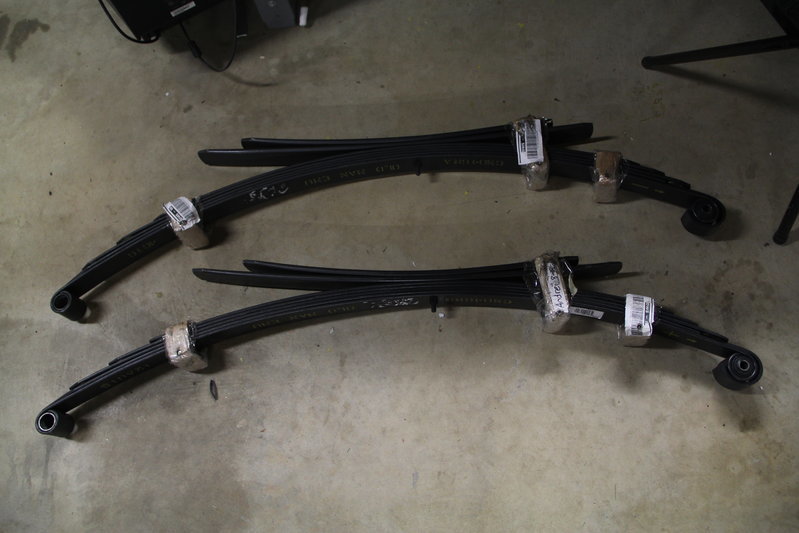

    Something came in the mail today for me.
    Thanks Wheeler's Off-road.
