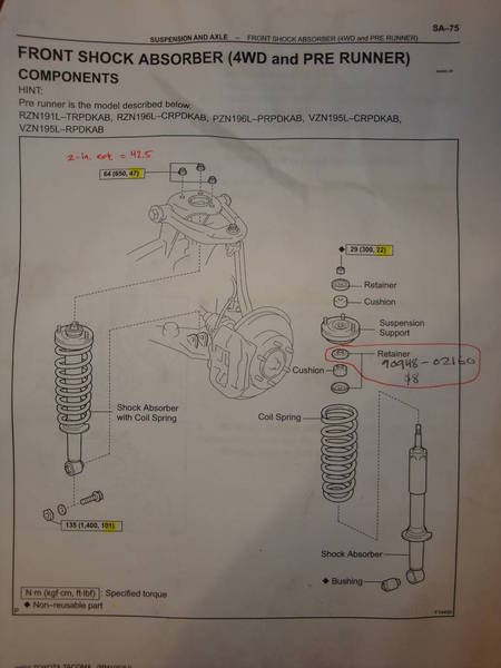

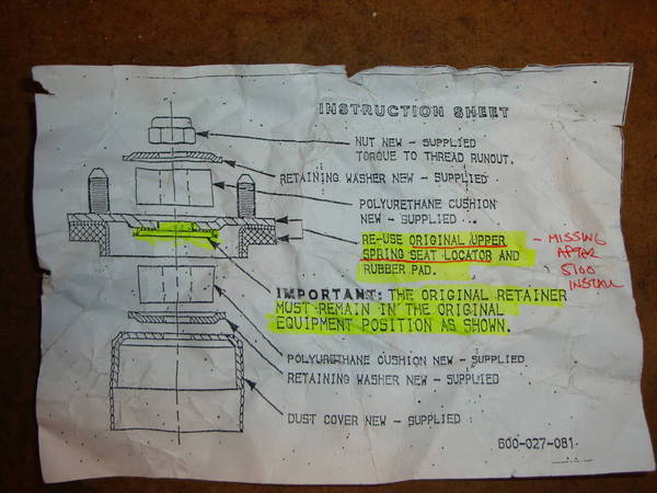

  6. Oct 19, 2012 at 9:07 AM
    #246
    scocar
    scocar Patron of the Farts
    Nov 11, 2009
    #25814
    40,079
    You've hit on an interesting point that stopped me dead in my tracks when I was swapping from 5100s to nitros.
    The stock top plate etc. is fine. What may not be fine are the little metal retainers. One retainer fits immediately under the top plate (see "suspension support" in diagram below). This was missing when I took the 5100s apart and tried to install the Nitrochargers, which would not fit snugly against the top plate. There was play that would be a problem. Note that part number circled in red, beacause the dealership did not have them in stock and had to order it from the central warehouse, and it took two days to show up, which meant I had to reassemble the 5100s and then tear it apart again two days later. Not fun. I recommend getting this in advance to be sure you have it on hand.
    The OME instructions explicity state that you need it:
    Hamer95USA likes this.
  7. Oct 19, 2012 at 9:35 AM
    #247
    Digiratus
    Digiratus Adventurer
    Mar 26, 2010
    #34006
    23,828
    Roaming the PNW
    The RedHead
    2002 XtraCab TRD 4x4 SCv6 AutoTrans With Lots of Mods ADS COs w/Compression Adjusters Camburg Uniball UCAs Whiteline Lower Control Arm Bushings Kartek 7" Limit Straps Plastics Guy Front Bumpstops Total Chaos Sprindle Gussets Custom Alcan Springs +800 lbs +3" ADS 10" Stroke Triple Bypass w/Resi Rear Shocks Custom Rear Shock Relocate All-Pro U-bolt Flip w/Timbren Bumpstops 4.88 Nitro Gears ARB Front Locker ARB Twin Compressor Black 17x8 Konig Countersteer Type X 285/70r17 Falken A/T3w Gunmetal 16x8 SCS Ray10s 255/85r16 Maxxis Bighorns Limited Edition (Relentless) Elite Front Bumper Smittybilt X2O 10K Winch Diode Dynamics SS3 Sport Selective Yellow Fog Lights in the Bumper Diode Dynamics SS3 Pro 4,000 Kelvin SAE Driving Lights with Clear Lenses on the Bumper Morimoto D2S Projectors XB35 Ballasts + 4300K Bulbs Badland Sliders FrankenFab Tire Carrier Swingout bumper w/kitchen BudBuilt Front & Bellypan Skids BAMF Rear Diff Skid Dometic CFX 55im Fridge/Freezer Alpha II Hardshell RTT Badland Custom Bed Rack Denso 210-0461 105 amp alternator Dual Northstar 24F AGM batteries BlueSea 7622 ML-ACR Battery controller Peak DBI Dual Battery Voltage Monitor Haltech IC-7 Display with Mako Dash Insert Haltech Elite 2500 Standalone ECU Magnuson MP62 Supercharger w/URD 2.2" Pulley Doug Thorley Headers Denso 650cc Fuel Injectors Aeromotive Stealth 340 Fuel Pump TransGo A340F Reprogramming Shift Kit OEM ECU Delete Full A340F Trans Control with the Haltech 2500 ECU 2.5" Magnaflow Hi-Flow CAT Magnaflow 18" Muffler w/Vibrant Resonator 13WL Brake Calipers with OEM Rotors & Pads Braided Steel Brake Lines Kenwood TM-71A Dual Band Ham Radio STI-CO Flex Whip VFH/UHF 1/4 Wave Antenna Midland MTX275 GMRS Radio w/Roof Mount Antenna Pioneer DEH-P9400BH HU Alpine Amps & Type R components (F) and coaxials (R) Wet Okole Seat Covers Weathertech Digital Liners Deck Plate Mod 1" Diff Drop Carrier Bearing Drop
    This makes sense if you are swapping shocks, going from 5100s to OME Nitros but 96Taco is only swapping coils.
    I don't see how this impacts the use of the top plate and associated components if the same shock is used. If the 5100s do not require that retainer to be there, it doesn't seem like simply swapping coils would change that.
  8. Oct 19, 2012 at 9:59 AM
    #248
    scocar
    Nov 11, 2009
    #25814
    40,079
    Whoops. You're right, Mike, I misread his post and focused on "5100 and OME" and my internal klaxon went off about when I swapped my shocks. My bad, good catch. :eek:
    Regardless, I hope this helps anyone who is swapping 5100s for OME shocks. :)

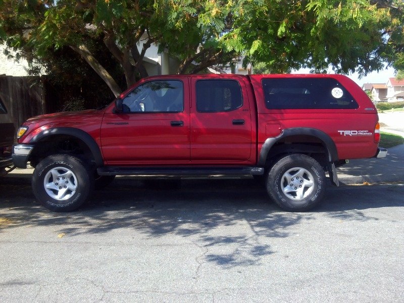

  13. Oct 19, 2012 at 6:46 PM
    #253
    BorisTheBear
    BorisTheBear If anyone's havin sex with mah sister it's me!
    Mar 3, 2012
    #74068
    27
    Boris
    Lynnwood, WA
    2016 TRD off road double cab long bed
    Rokblokz mud flaps 6500k 55w hid headlights and fogs Rockford Fosgate P3S-1X12 sub
    right after the install. truck sits a little lower now.[​IMG][/IMG]
