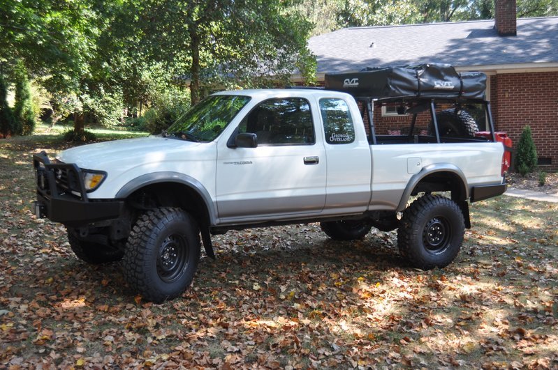

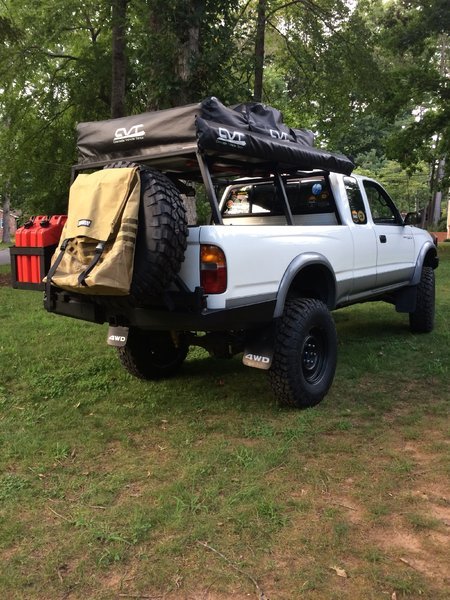

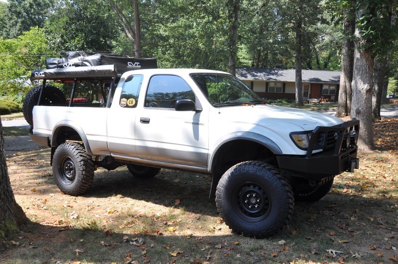

    OME front and rear suspension, ABR deluxe bull bar, Black FJ 17 inch SEMA wheel with treadwright 265/70/R17 E, Bushwacker fender flares, Stock rear bumper, Eagle 4 wheel camper.
    Ok here is my '96 with OME set up AND ARB Dluxe Bull Bar bumper.

    :jellydance: still diggin' the pop-up. Seriously have been thinking of a 2nd truck just for this.
    Any chance for a full side shot to see how much it hangs over the back?
    Maybe full frontal too, of the truck :p, to see how much it hangs over the side as well.
    Thanks!

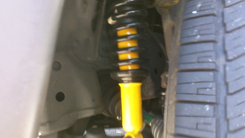

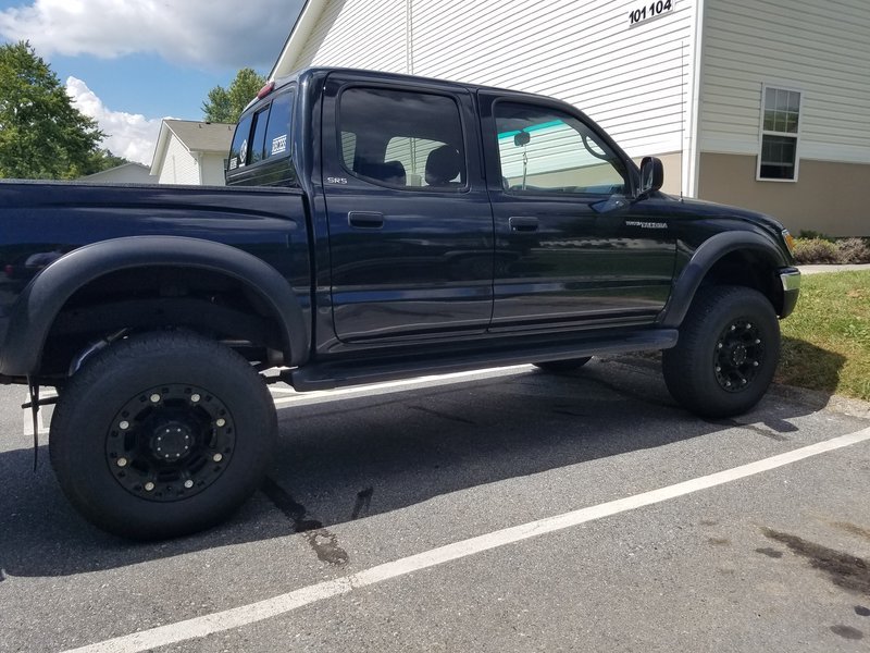

    Got my kit put on today! 882's up front nitrocharger sports all around. I put a Deaver AAL in the rear and the bro lean was pretty bad. I ended up having to leave my 1.5 inch block back there to keep the truck level (small amount of forward rake). This is only temporary though. I'll be getting the Dakar pack for Christmas and an adjustable shackle set.
    Did a diff drop kit as well and my cv's look really good. No boot rubbing. UCA'S look decent, a small amount of slope but not bad at all. Really happy with this lift and will be even happier once I get the dakars and get rid of that block. At least I got rid of the front spacers and stock front struts.

    Sure man there are several pics on here in my media. Look up my albums and see if any of those work for ya. If not I will post more shots here. I will say the one they make for this bed is a bit bigger now but worth it. Mine can be purchased however....

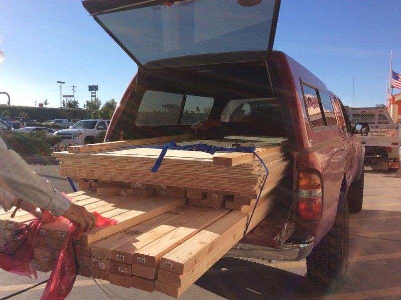

    Yeah, that's a hefty amount of lumber. You shoulda seen the guy's face when we were drivin back with it and I told him it was a 4cyl. Went over some pretty jank parking lot surfaces, 30miles of freeway, and another 10 miles off road without really noticing much other than a little sluggishness. I've got Cooper St maxx 255/85/16s on stock steelies. UCAs were to allow for better geometry due to both taller tires and the couple inches of lift from the OME.

    Damn that sounds great. I'm actually thinkin im gonna go with 235/85/16 instead of 265/75/16. I like that pizza cutter look and from the studies ive been reading traction is great, especially on snowy roads.
    Plus they a tad cheaper.

    108
    There really is no way to tell. For instance in my double cab V6 my 882s have given me 3 inches right at install but after they settle I will be around 2.5 to 2.75 inches. Some people have gotten close to 3.5 inches in the same body style truck

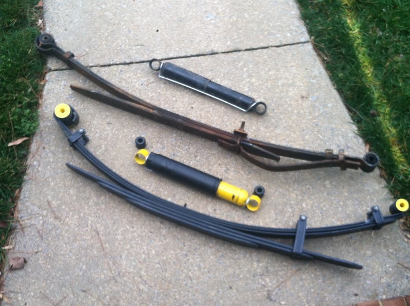

    OME 2882 Coils
    CS019R Leaf Pack
    D6XL AAL
    Nitro Chargers all around
