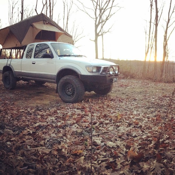

    Im not sure on how much weight for the 883's but I had 880's with my front plate bumper/winch and the Toytech AAL before I made my rear bumper/swing out and it sit pretty level even with the rack and tent on the back full time. So Id say you'd be fine with 881's. Totally just my opinion though. Im no expert by no means just giving you more information to help with your decision. Good Luck!
    Found this picture of my truck with the 880's and Toytec AAL before the rear bumper. Maybe this will help too :thumbsup:

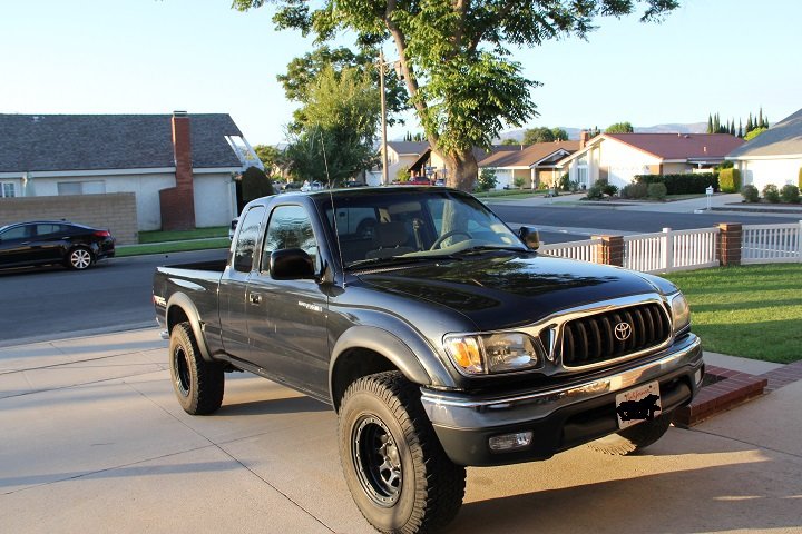

    Finished installing my new springs yesterday. OME 881 coils with Dakars, no AAL.
    The day i bought her.
    After the lift.
    The old junk that i pulled out.
    First impressions are that it is a lot stiffer than stock but the tires seem to more planted on the ground. Next i will have to buy shims to straighten the drive line.

    I noticed toytec's site says something about a top plate spacer. Are you not running that? Just curious cause of the rake
  17. Sep 19, 2016 at 10:59 AM
    #2617
    yodataco
    yodataco Well-Known Member
    Jun 9, 2013
    #105921
    716
    Alex
    Orange County, CA
    2000 4Runner
    MCM fab 3.5" LT front, OME 861 rear
    No top plate spacer installed. I bought the spring kit from Wheelers Offroad. The rake is a little much but im hoping the rear will settle as it breaks in, especially when i start adding weight to the back.

    What's your rear hub to fender measurement?

    OME, sliders, dents, hail damage, soiled armrest. Lightbulbs.
    Thanks for the pics! A couple questions...
    What size tires are you running?
    Have you considered pulling out a leaf or two from the Dakars (if that is too much rake)? Maybe someone will chime in, but I think a common recommendation was to pull out the 3rd leaf or the second overload? (not sure)
    Did you use a driver's side trim packer? (is the driver's side lower than the passenger side up front?)
    KiteGuam and Tacoverlander like this.
