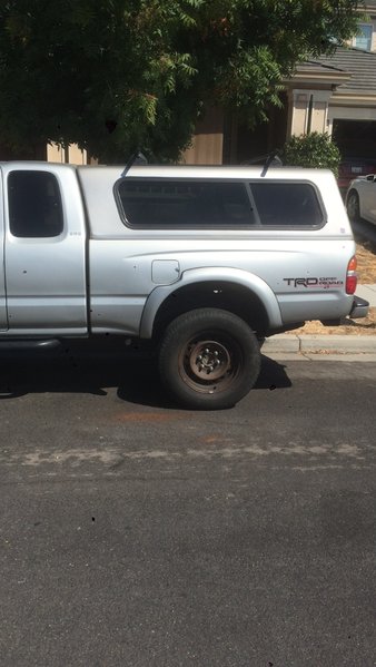

    I think its a 4x4 actually.
    And Mr206, SCS F5s look :thumbsup:

    Yup, you're right!

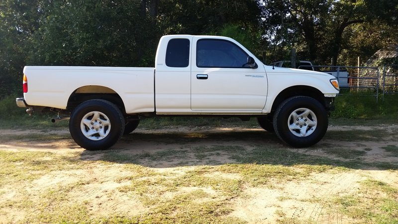

    Dakar rear leaf on OME greasable shackle with Nitrochargers in the rear. KYB strut on as yet unidentified OME front coil. 265/75 Toyo A/T. 396k on ODO.tmp_5429-20161003_164605-655755628.jpg
