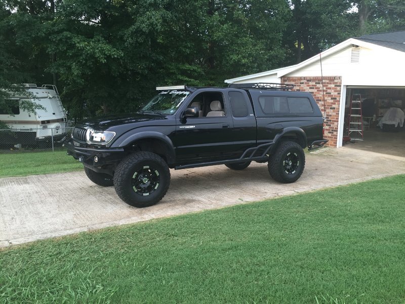

    Here's my OME lift with:
    882 coils
    1in Daystar Body Lift
    295/75/16

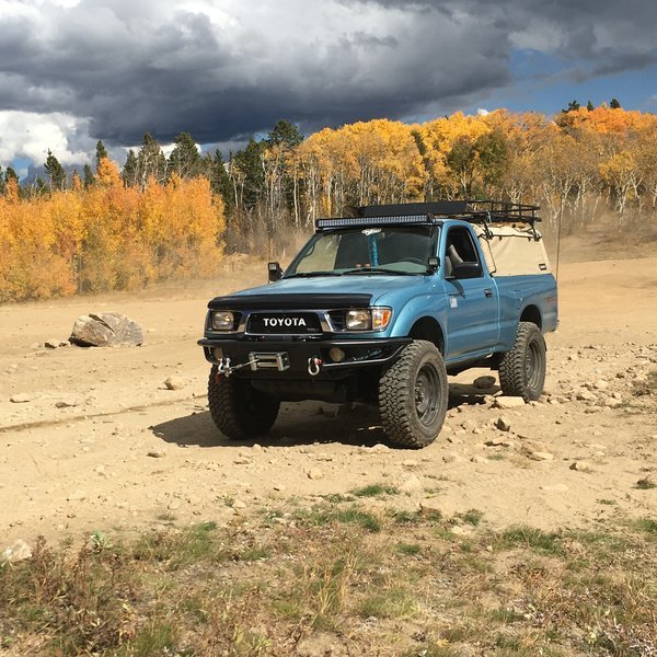

    image.jpg 95.5 single cab. 2.7. Rough country shocks (oem height), old man emu 2881 coils, 10mm poly spacers, and 1.5 wheelers aal out back. 255/75/17 tires.

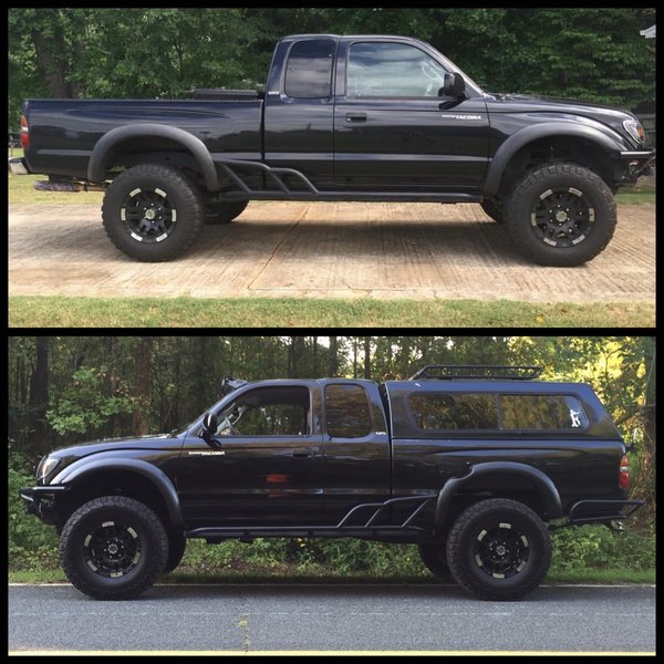

    Stock height to right after adding the 882 coils, nitro charger sports, and an add a leaf
    Going from 882 coils, nitro charger sports and add a leaf to all that plus a 1.25 Daystar body lift
    Tires went from 265/75/16 to 295/75/16
