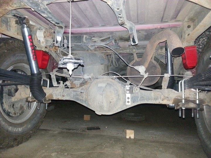

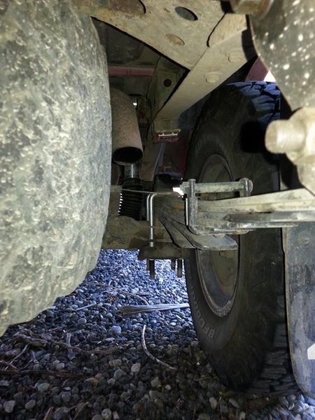

    I have 02 double cab with front with winch and rear bumpers, sliders, canopy, and rubber bed mat. I had the height I was going for right after installing my Dakars(39.5" ground to bottom of rear fender, running 265-75-16 k02s) with stock shackles. However, upon returning home from my maiden voyage across 2 states (800 miles round trip) with camping gear, I realized that I had they settled to the same amount of lift (no weight other than mentioned stuff) as my worn out negative arch leafs and 2" lift shackles (just barely 38"). I will be ordering the AAL as soon as Headstrong gets them back in stock, but my Dakars are already flat. Is this a normal condition? I also know my u bolts are too long, I was anticipating going directly to installing my AAL and angle shims to combat drive line vibrations.
    also, Yea, my bump stops ran away. FML. I needed to keep stock bumps for proper tightening of the dang u-bolts.
    My friend has 4 year old Dakars on his 99 ext cab, and they have positive arch. He has even loaded down his truck with lumber and not sagged as much as my leafs.

    From what I've heard and read about the Dakar's it looks to me that you got a bad pair.

    The Dakars are meant to have very little positive arch, they give the best ride characteristics when they're almost flat. Unlike other leaf springs, they can be run with slight negative arch without damage. Your double cab is heavier than an extended cab, plus the weight you loaded them with will cause them to settle a bit. I would put the CS046R extra leaf in, it will pick them up a bit and also give you additional weight capacity.
    You don't need to keep the stock bumpstops on to tighten your u-bolts, unless you're running out of thread and need to shim them up or something. I would get rid of those and put a bump plate for your ES bumps.

    so, that's exactly what I was thinking at first, but after seeing a few double cabs with any weight, It kinda looks normal, and Im not only going to need an AAL, but probably the lift shackles as well when I upgrade to 255-85s.
    This agrees with what I read after researching. I do plan on the AAL as soon as it comes back in stock at headstrong. I did need the stock bumps because I was running out of threads on my too long of u-bolts, as I was planning on going straight to AAL and angle shims, but forgot to order shims and AAL was out of stock at the moment.
    Now, next question, Has anyone run different AAL for the Dakars? Maybe a 3 leaf progressive or some other strange combo that'll give lift and carying capacity? Constantly running a NWTI rear plate bumper, snugtop canopy and thick rubber bed mat, also frequently tow 12' aluminum boat in fishing season.
